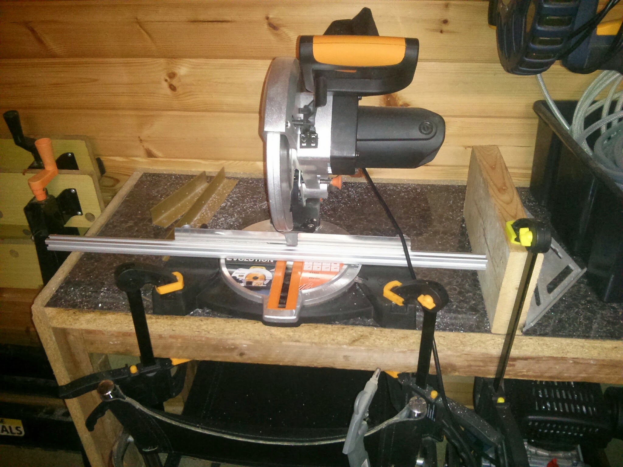

Thanks to all who commented on cutting down the aluminium profile. I spent a little time squaring the blade on my chop saw (it’s an Evolution RAGE saw and went through the extrusion no problem)
The rather basic clamping endstop to cut all the pieces to the same length worked nicely and I have 10 300mm lengths and 4 400mm lengths for my printer with 1400mm left over for the z bed.
