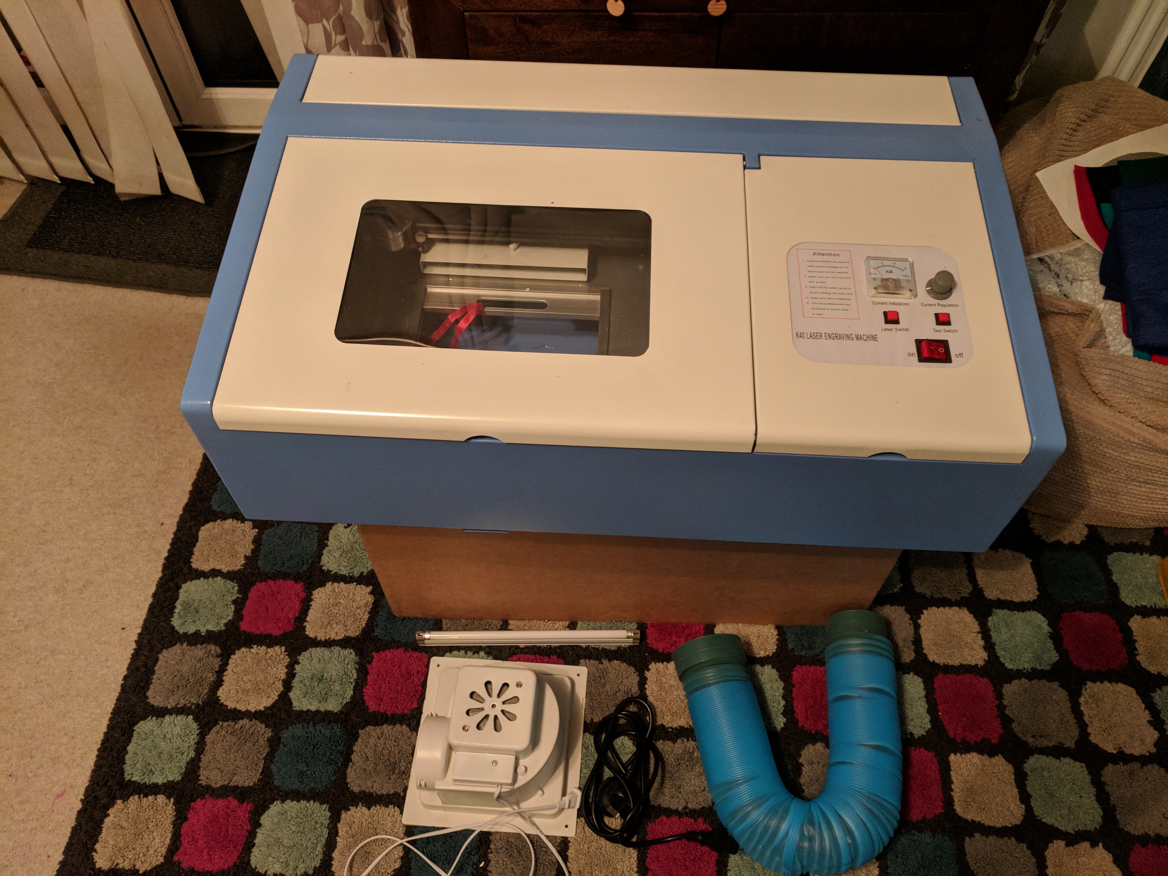

Thanks to pressure from HalfNormal I am now the proud owner of a second
Thanks to pressure from @HalfNormal I am now the proud owner of a second slightly pale looking M2-nano powered K40. At a a very reasonable price it now seems this little fella has never actually been fired. Bed size seems to be 330 x220, the usual K40 safety devices (not) installed. None pwm power supply.
I quickly made up a male to male usb lead and installed K40 Whisperer, a few moments later I was jogging the head around and test firing the laser, I’m pleased to report everything works as it should and even the mirrors are aligned.
