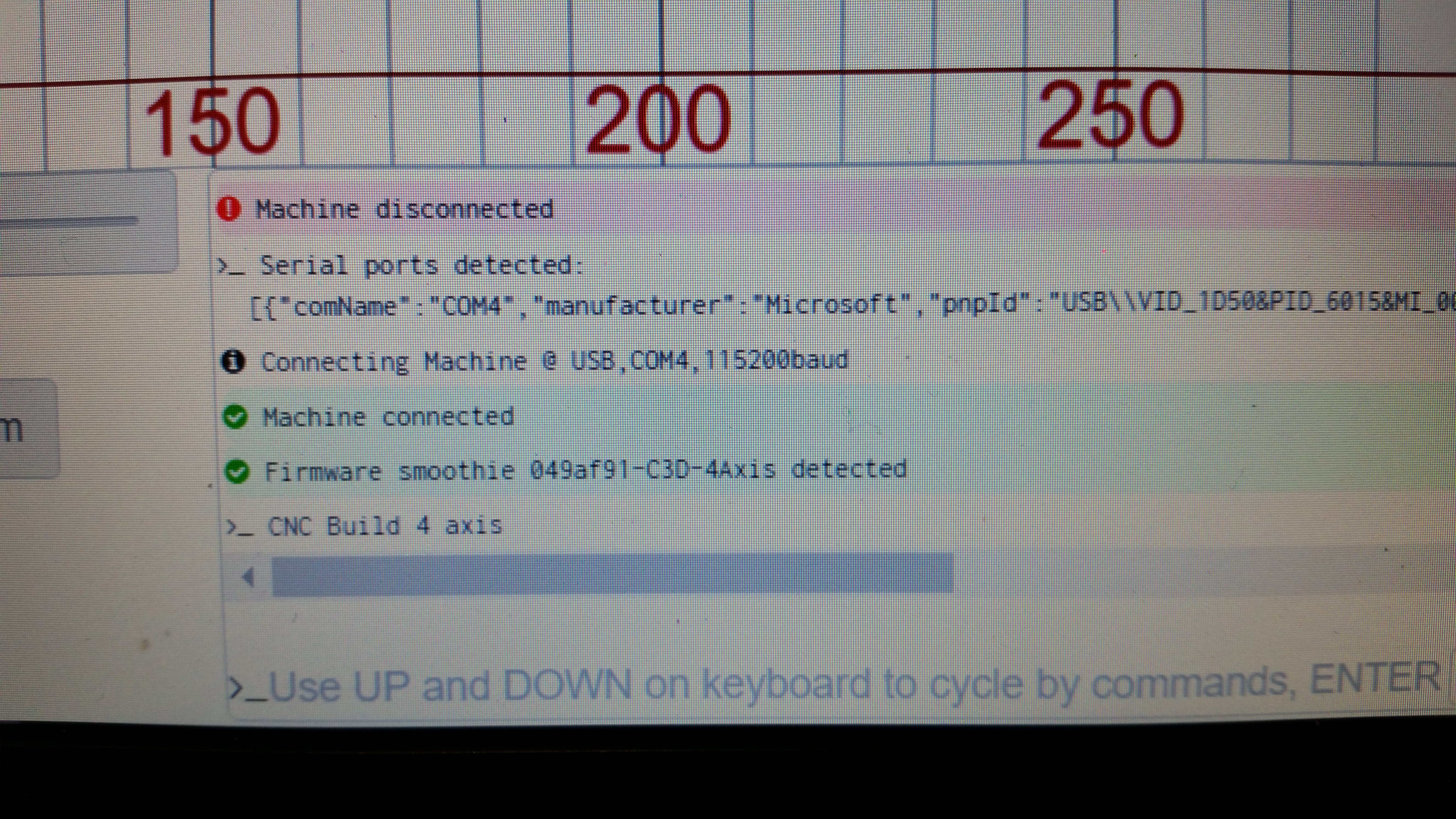

Thanks to Ray for getting me the .BIN and the Config file for 4 axis.
All loaded up ok.

A moves but does not show any movement on screen. I can jog via Laserweb4.
(please see video https://www.youtube.com/watch?v=Zc0USKY-g7A)
There is also no A on the reprap screen . I mostly run from screen as a standalone.
when I post a program with A moves it looks ok on Laserweb4 but the program stops at the first A move,
What am I missing?

If i load the Gcode to the board then it will run and A moves but still no readout on screen in laserweb4.
This makes me thing its a laserweb problem?
Running latest version of all software
Help please.
