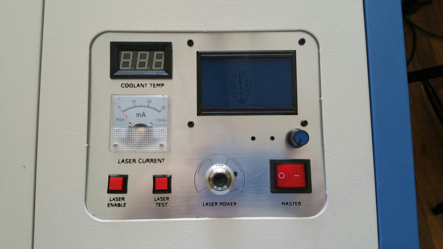

Thanks to Ray Kholodovsky for the help… A new control panel was my first project and it turned out well. Done with C3D Mini and LW4. Biggest problem I had was getting laser power low enough for vector engraving. Cutting was a breeze. Engraving speed was 1000mm/min at 3% (of 10ma) power. Cutting speed was 1000 at 50% power. Naturally I had to scratch the panel installing it… (doh!)

Not sure… Got it here: https://www.amazon.com/gp/product/B01N5STGNU/
4x 600mm by 300mm sheets?
Yes, four 600x300x1.5 sheets. Cuts and engraves well.
Awesome!!! Thanks for the link
If you’re doing low power stuff set the pot to 5mA and adjust the LW pwm % accordingly.
You might be able to get better pwm range resolution.

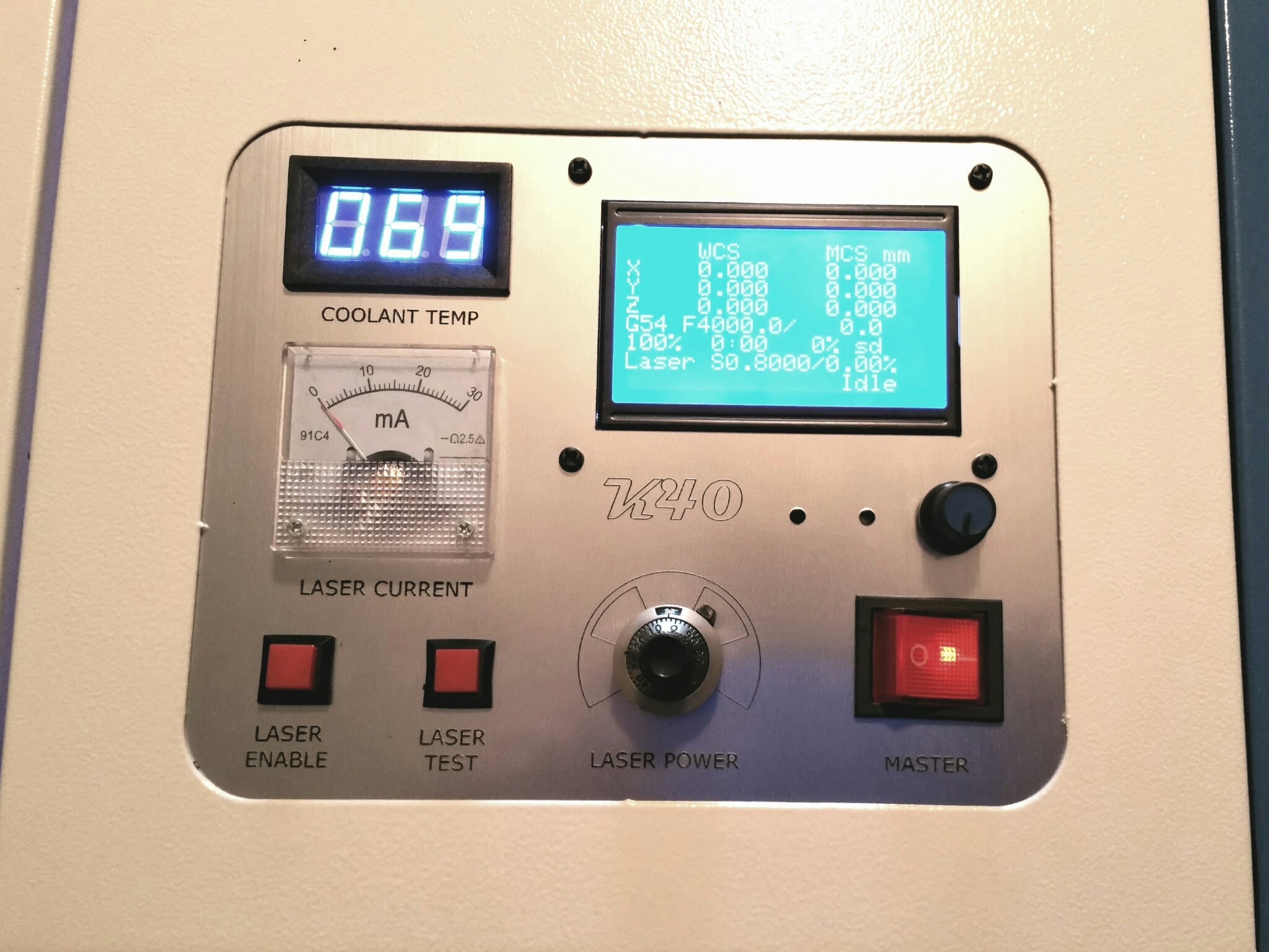

Final version:
Oo that’s sexy! Nice work @Lance_Ward !
