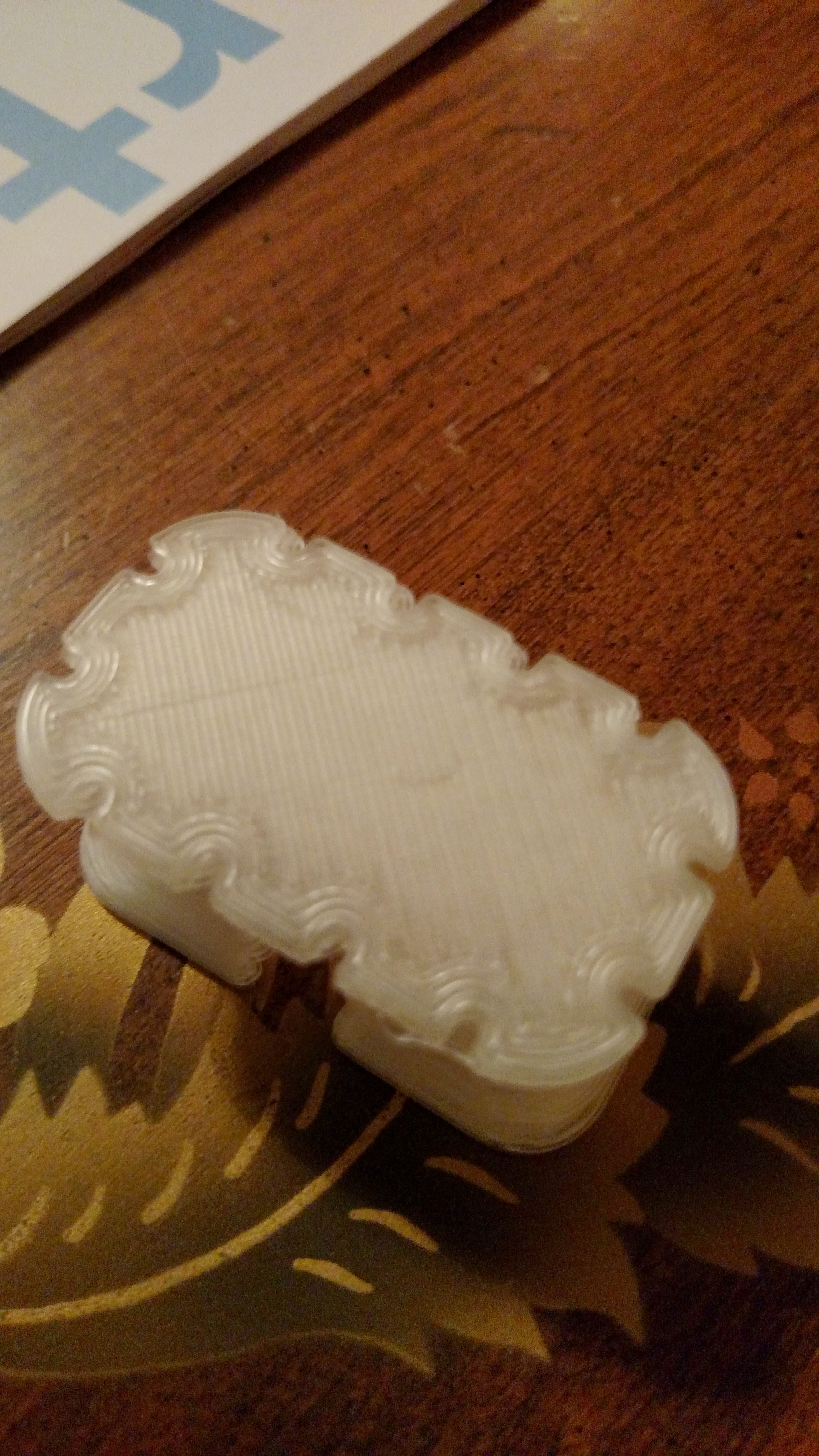

Thanks to you all I managed to get my layers to work perfectly.
Thanks to you all I managed to get my layers to work perfectly. A combination of Z-offset, the extruder screw being too tight and the current of the extruder motor being too low. Here’s some pictures.
The photo of the bottom of the print demonstrates the layering I’m getting now. Great improvement!
