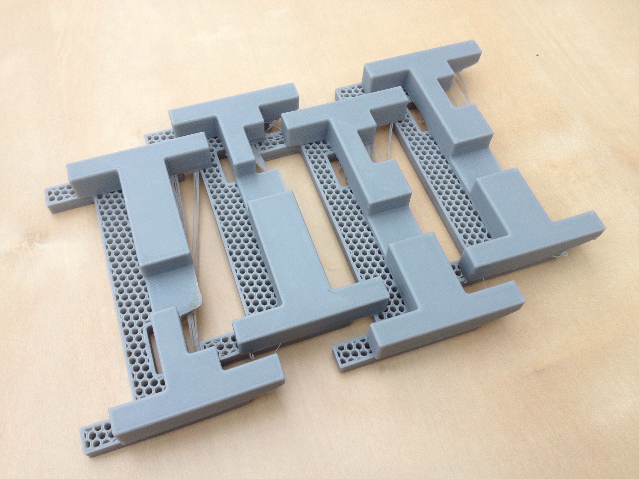

That awful moment when you discover that instead of the last four pieces of a puzzle, your printer has spent 7 hours creating another piece of ‘art’!
What went wrong?
Shifty character, your printer.
Hard to be sure after the event (it happened while I was asleep).
There must have been a sudden major slippage that only happened once, so I’m guessing that one of the pieces warped slightly and snagged on the nozzle.
had that one or two times, but with a 90° turn midprint … nice wtf moment
I thought the design was attentional at first, its a cool looking fail. I’ve have slippage on my makerbot replicator a few times, still don’t know what exactly causes it, but seems to happen when we’re asleep
I’ve had step slippage similar, but not a pronounced, when my grub screw on the X-Pulley was not aligned fully with the stepper shaft flat.
I was getting that when I switched to the latest slic3r. The acceleration settings in it where too fast, causing my printer to skip like that. I don’t know if that’s the case for you, but if you just switched to the newest slic3r…
I get these wtf moments Every once in a while. Still working the kinks out of my system.
