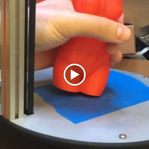

That awkward moment..
That awkward moment…
#shoudveusedinfill haha. Happened to me before. Print looks amazing otherwise!
Yeah the printer auto-levels against the aluminum bed, so adding blue tape squishes the first layer really well… too well (not scratching).
Haha… “Do you even lift, bro?”
Yes. But not in that ABS way.
