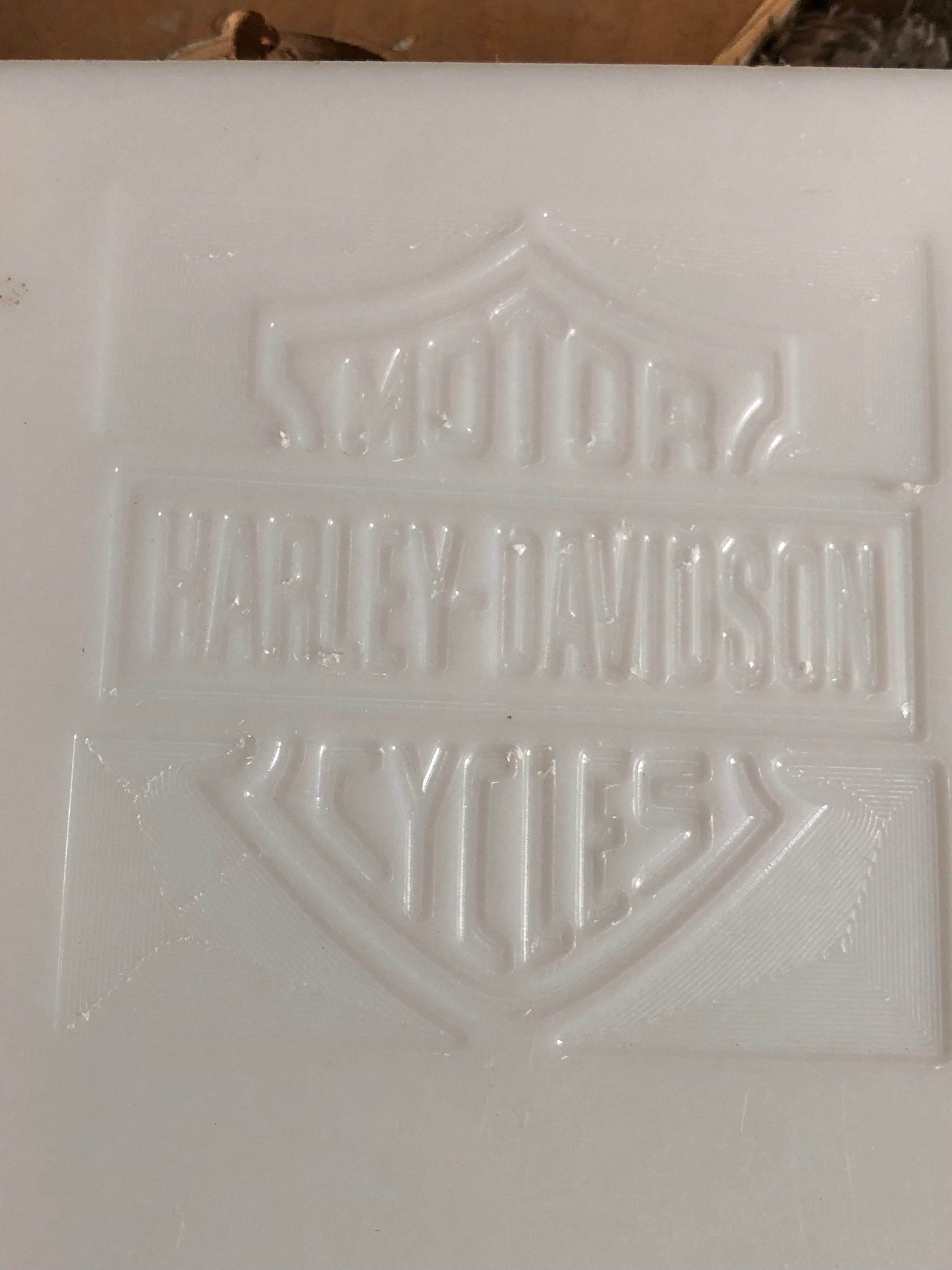

That design on my 3020 came out well.
Nice, and shiny… What Kind of Material is that? Wax? HDPE?
@Werner_Drasch HDPE. I made the image using an online photo and traced the inverted bitmap image on Inkscape. Saved it as an svg file and sent it to http://jscut.org to generate the gcode. Then cut it out on my 3020 using a planetCNC controller and a 3.125 mm ballnose bit.http://jscut.org
