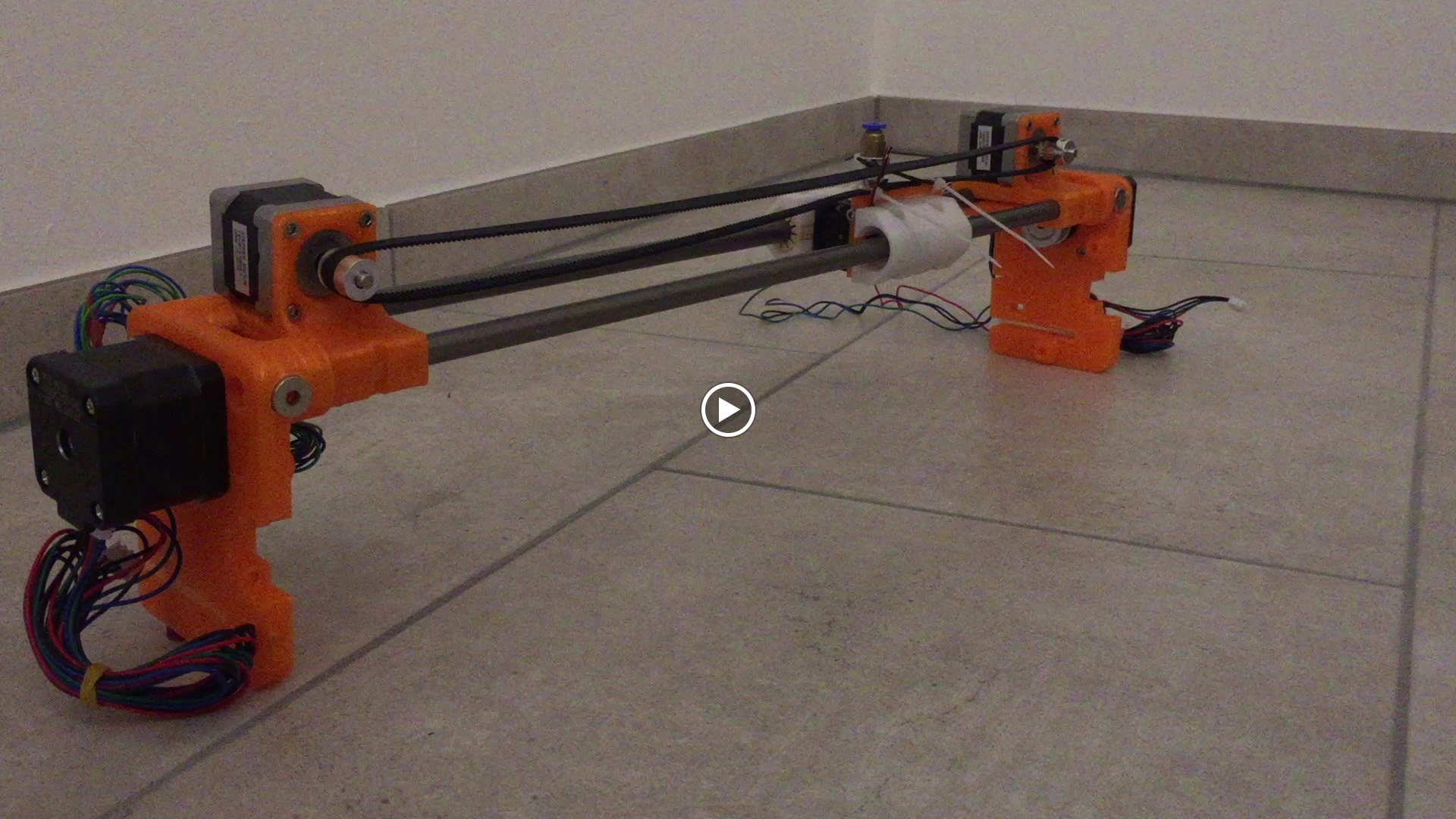

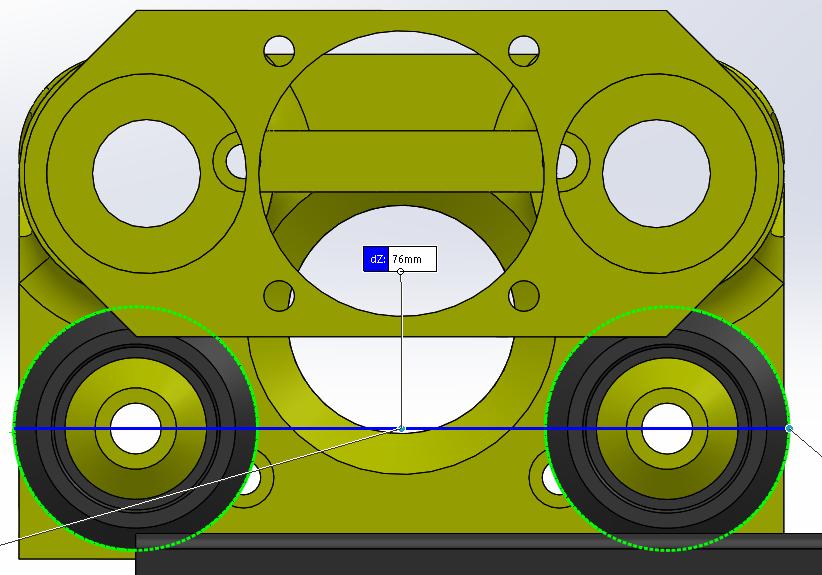

That is the gantry I’ve made for the OpenMultibot: 2xNEMA14 for Y + 2xNEMA17 for X. Total width is 76 mm. Can test when build the frame. If you know narrower solution please let us know.
That’s a sloppy belt. Tighten that up please.
Why 2 NEMA 14s? Too much extra wiring. I’d just do a single NEMA 17.
Tightening the belt takes place after the gantry is mounted on the frame and there are 3 tightening possibilities.
Twins evenly distribute the dynamic loads between the two sides of the frame and work better than a single side drive made in QuadStrap on GitHub.
A NEMA17 (instead of 14) increases the total width and levels higher the belt hook on the Y-slider.
76mm total width seems weird to me. Typing mistake?

I am tinkering with 450mm MGN7 guide rails and cannot get much better than 507660mm by the time all the parts are in place so your dimensions look good.I hope to post some pics in the next few days. Your build is much bigger than mine, so you need to forgo some width to in order to retain stiffness.
No doubt they will yield a bit with experience, but with a multibot you are ultimately limited by the motor size unless you go for a pulley
and cable system.
I’ve tried nema 17 pancake motors (17 and 21mm body height), but you get a 42mm cube by the time the shaft and pulley is added. This puts an ultimate limit on the gantry size.
Smaller motors lack torque and will need gearing to drive the load reliably and fast. I’ve only got Nema08 motors which can co very little without gearing. I’m thinking of RC continuous rotation servos with encoders. That means software and electronics changes, which is probably a requirement for multibot anyway
The cooling towers and filament feed path are also a limiting factor, and probably need redesign for multibot where narrow gantry is indicated…
