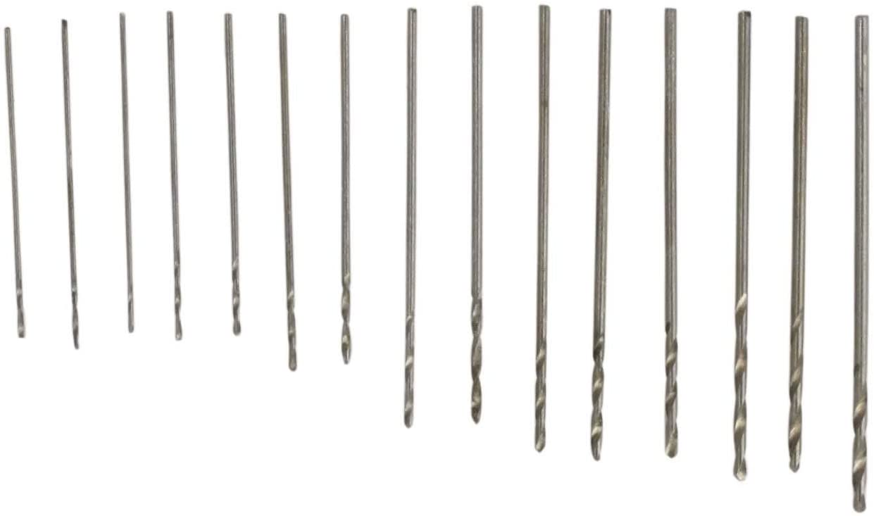

Where on earth did he get a 1/64 in (0.4mm) drill bit?
@John_Ridley you definately have a point there with changing colors. I’ve only done black PLA and ABS so I haven’t had that problem yet.
@NathanielStenzel not sure. I’ve got my 0.3 and 0.4mm bits on ebay.
http://www.ebay.com/itm/10x-0-3mm-NEW-Carbide-PCB-Dremel-Jewelry-CNC-Drill-Bits-/130401272644?ssPageName=ADME:L:OC:GB:3160
http://www.ebay.com/itm/10x-0-4mm-NEW-Carbide-PCB-Dremel-Jewelry-CNC-Drill-Bits-/140418100959?ssPageName=ADME:L:OC:GB:3160
They are so far untested but they look fine.
Ah. Newark.com may work for me. They sell one.
This might do too.
