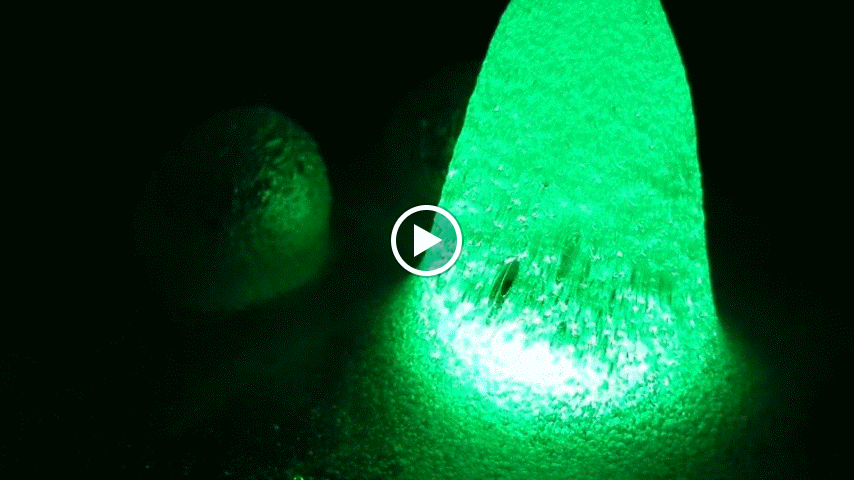

that´s whats stefan´s scetch is doing with my objects ;-) works fine - Thanks
that´s whats stefan´s scetch is doing with my objects :wink: works fine - Thanks
It looks like the minimal values for red and blue could be a little bit higher in order to avoid the visible brightness steps when fading to the low end. Try to set min_r and min_b to 5 or even higher.
8 Bits give not enough resolution for really smooth fades within the lowest brightness area.
I played a bit arround with the values and mixed a spoon chillired to the green and blue. :wink:
