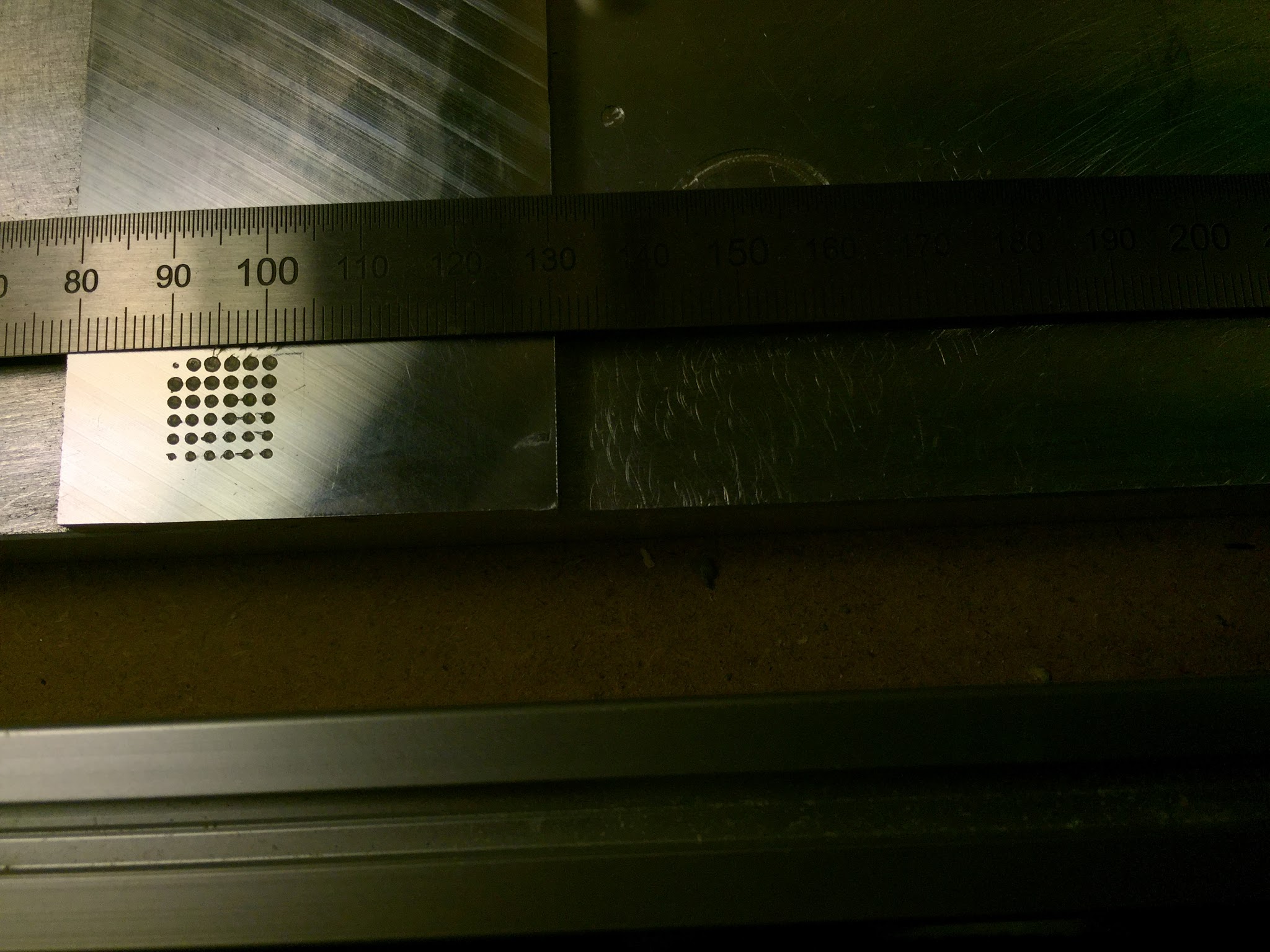

I use a complete new system to apply this drops. I’ll present this tomorrow in my next video session. But now, some pics for you.
Here you see maked drops with a 0.60 mm canulla. The drops are flux paste, not solder paste at this moment.
The first (bottom) line has 0.5mm and the last (top) line 1.0mm move on the solder dispenser controller. Thats my way to find the best parameters for every canulla. In this case i would say 0.6 or 0.7mm (line 2-3) has the best results. I’ll create a library for chilieppr and the user choose only the color of canulla and get the best parameters.
