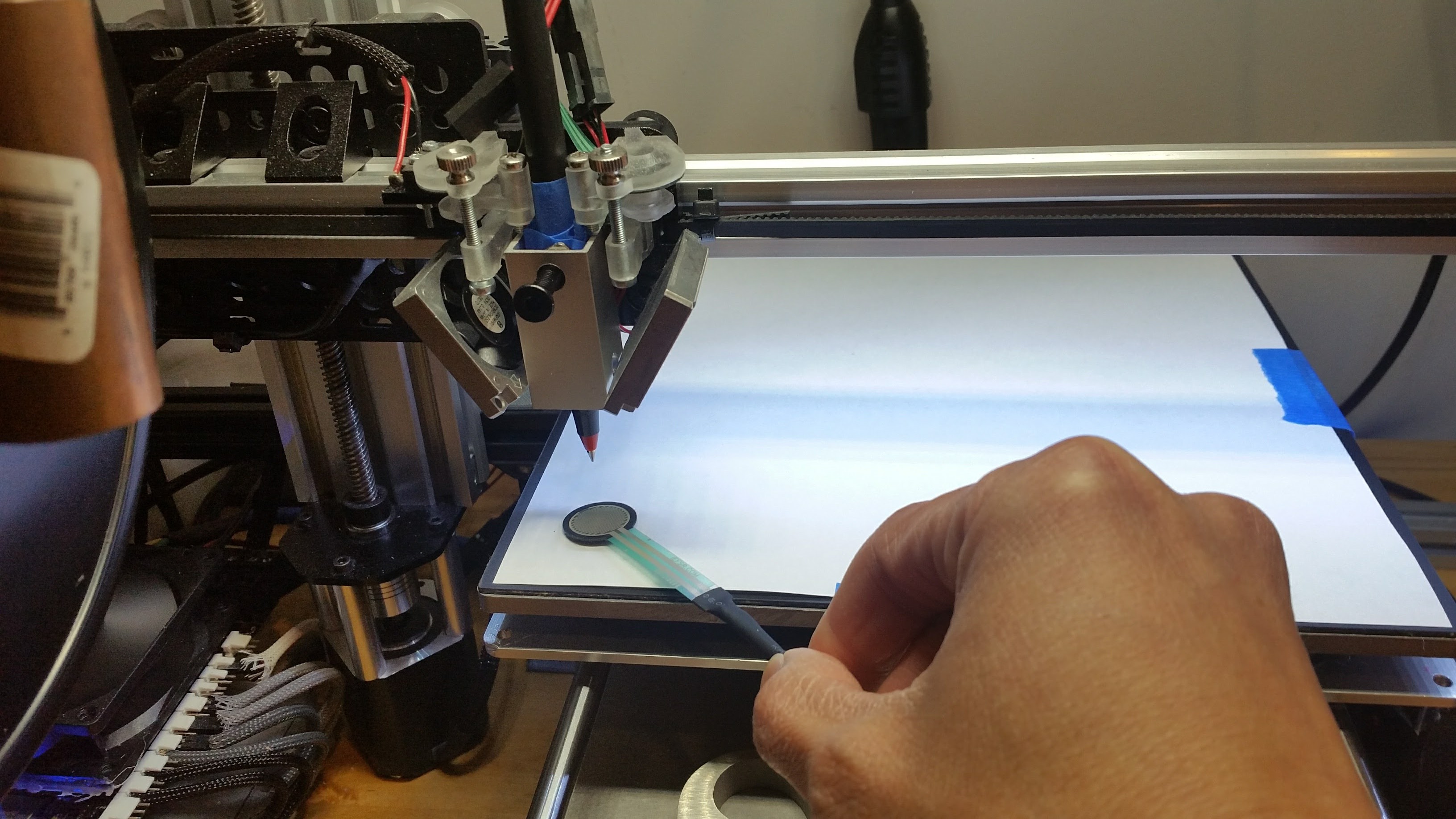

the 2 FSR above the hot end works but because my x axis is
the 2 FSR above the hot end works but because my x axis is a crane style, the points at far right areas would trigger the FSR after certain deflection. a bit disappointing but I found another way :slight_smile: More FSR of course.
So this additional FSR is more manual and I have to follow the head movement and intercept before it hits the bed. no deflection observed.
