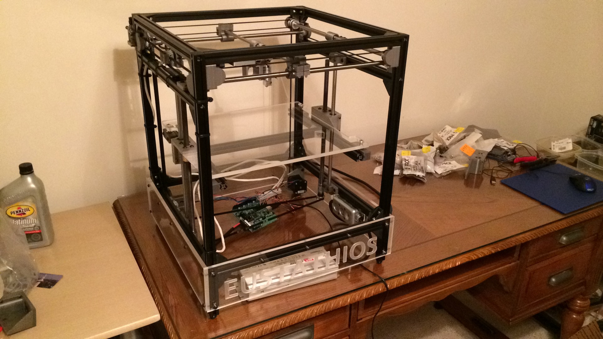

The 3/8" plexiglass is was milled on my "extended and improved" v1 shapeoko.
The 3/8" plexiglass is was milled on my “extended and improved” v1 shapeoko. Its more like a v2 actually. We used the 660 dewalt router. It turned out very nicely. It was all driven by tinyg and #tgfx using #http://makercam.com for the gcode cam generator. This printer is @Jason_Smith 's btw. It turned out very very nice.
Originally shared by Jason Smith (Birds Of Paradise FPV)
Some pics of the Eustathios plexiglass parts.
