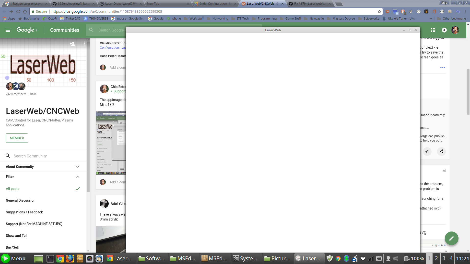

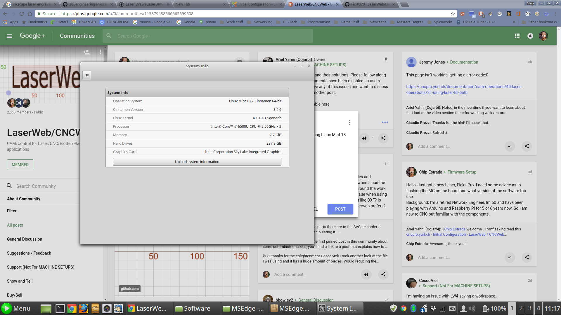

The appimage stopped working for some reason, I am running Linux Mint 18.2
Check intel driver, there’re posts of people reporting the same.
Nope that di9d not help, I’m confused because it was working, then it stopped and I had not made any changes to the system.
I manually installed LaserWeb3 and now Both versions work. except the LaserWeb4 does not show a grid
