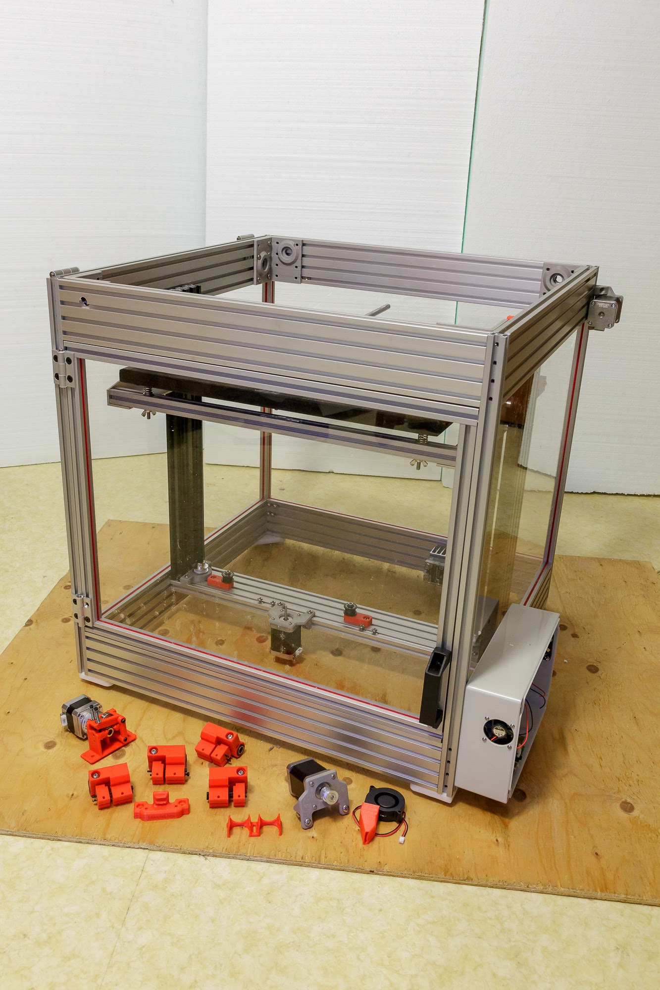

The birth of another #HercuLien ![]()
Thanks to @Eclsnowman 's Herculien design and @Nathan_Buxton 's 3D prints, here are some images of my HercuLien build in progress. I missed some bearings and a belt or two from orders so progress has slowed. I plan to post some photos of completed machine. This machine will use the smoothieboard and #OctoPrint .

Looks very nice! I wonder what is the large chamber on top for? Does it print up there or only in the lower half?
I’ve seen this done to trap heat in the past, but that IS a large attic going on there.
I think I had it modeled at 12 inches high to allow for capturing heat and also for cabling and Bowden tube travel. With a long bowden tube like this you want this gentle an arc as possible.

looking at the pictures, the picture showing the Top was taken at an angle and seems to make the top look higher than 12 inches.

@Marc_McDonald do you think I should drop the height of the lid at all?
@Eclsnowman At this time I am not using the lid, that will be next after I have resolved a small vibration in the Y axis(does not seem to affect the print quality at this time), the x axis works great. I plan to add some type of arch support for the boden/control/power cables to the inside of the lid, I have not verified if the height can be reduced at this time.
One item I would consider changing is to install the side walls outside of the frame so they can be easily removed so you can gain access to all parts of the #herculien as it can be challenging with the current design. This may also reduce some vibration of the side panels that I have noticed.
