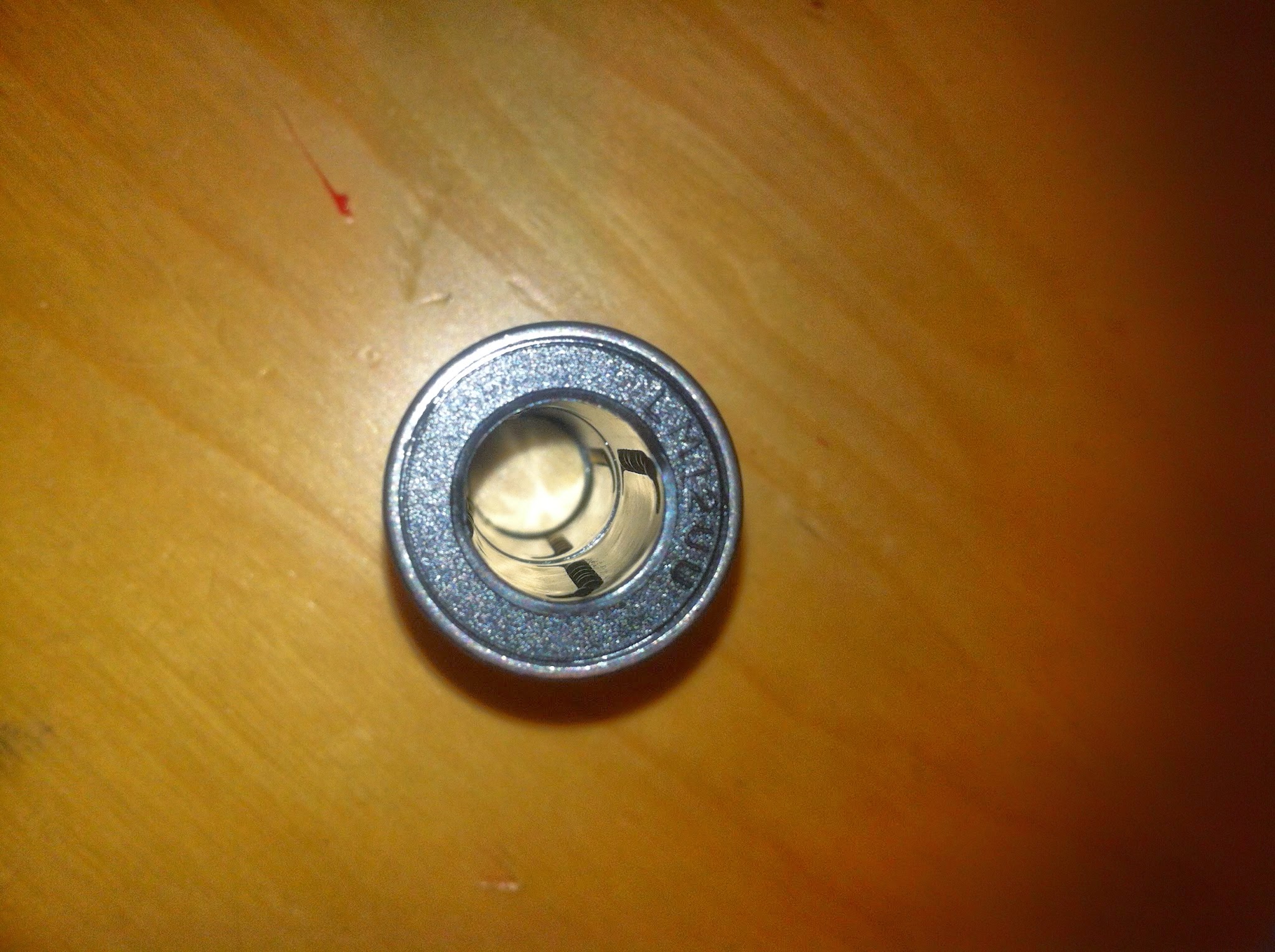

The build is definitely going to be challenging to get correct. I’m sure to have alignment issues. Also I hope I didn’t royally screw up my bushings, all I had was vice grips to press them in. I don’t have a clamp of any kind or a bench vice. Received the one wrong size linear bushing… LM12UU vs a LM10UU. Lastly need to enlarge the hole in the frame. The hole is suppose to be bigg enough for the screw to go in correct?

The linear bearing needed is an lm10luu. The second “l” is important, that what makes it a double length bearing.
Do not use two smaller ones stacked, you will cause binding issues.
@Eclsnowman Oh damn…I’ll have to relook at my order. I might have missorderd (thus an error in the google spreadsheets) or the vender sent me the wrong bearings completely.
Wow your really crunched up those bushings… If you do not have a press, you can make wooden plates (MDF), put holes in the middle of the plates, press the plates together with clamps to get the bushings into the parts.
Yeah I’m going to need new bushings. I doubt I will be able to take them out so I’m going to need new platic parts too…@Isaac I wish I watched the videos before I started. It would have saved me some parts
@Gus_Montoya no error on the sheet. The link is right… But you have to specify the “l” when ordering. I guess that part of the sheet should have a note.
@Gus_Montoya if the carriage and rod ends are ABS (mine are), use acetone on a qtip. Soften the hole (takes several applications), then press in the bushings. It needs to be a tight fit.
