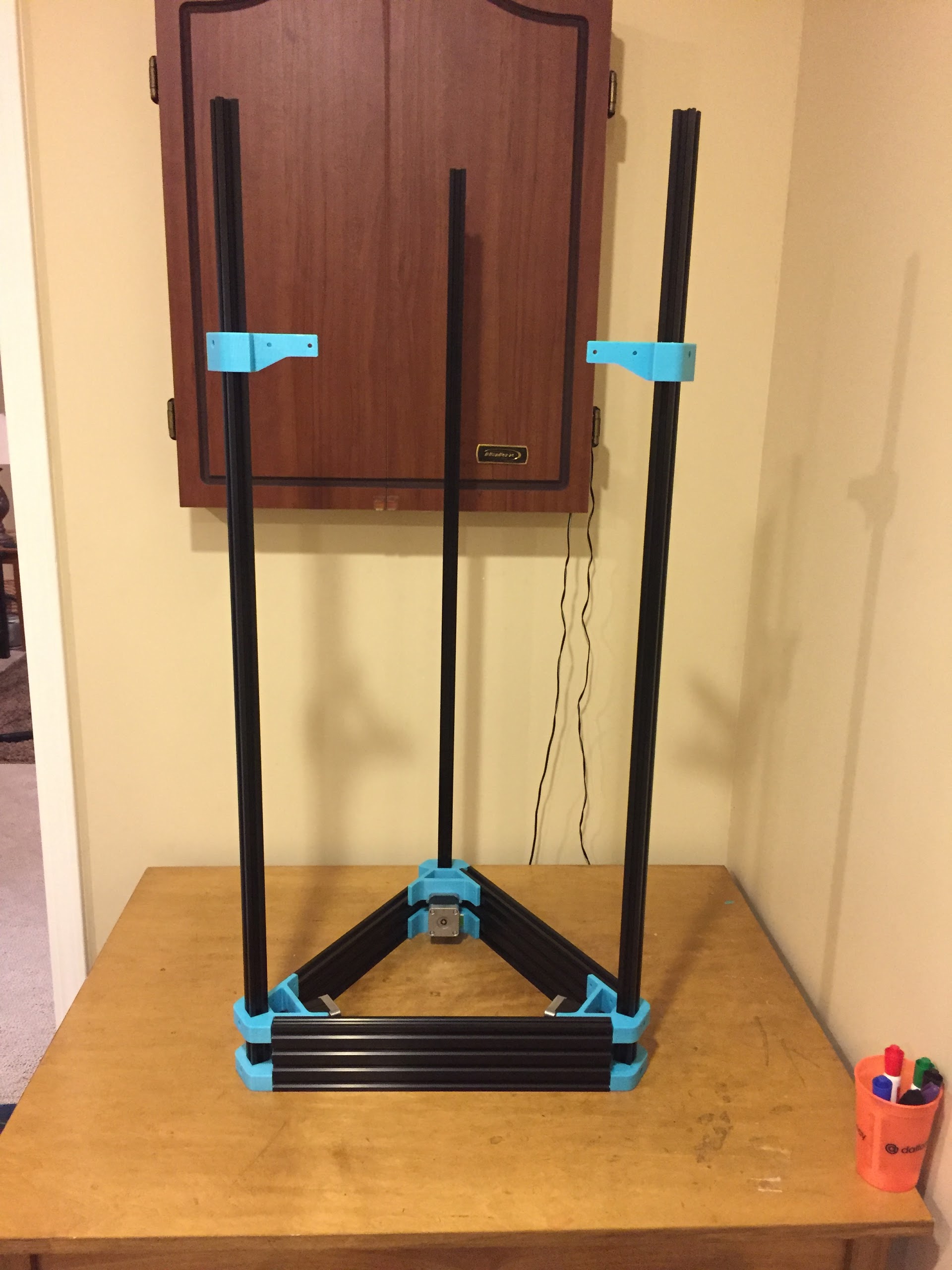

The delta builds are finally back! I’ve made some small corrections to the top and bottom mounts that make for a stiffer frame. The base uses 8020 on 2 of 3 sides to ensure that it remains stiff instead of the 2020 that I used throughout the last design. The top mounts are now beefed up to 40mm thick to ensure that there is no play.
The base extrusions are now 370mm and the verticals will be cut where the top mounts currently reside (800mm)
@Ax_Smith-Laffin convinced me that all black for all my printers is boring. So I went for blue and black! And man I love it! Hope to finish this one up soon.

I really like the multi color looks. Building a large Cartesian right now that is silver rails with black corners and electric blue printed parts. Looks awesome.
