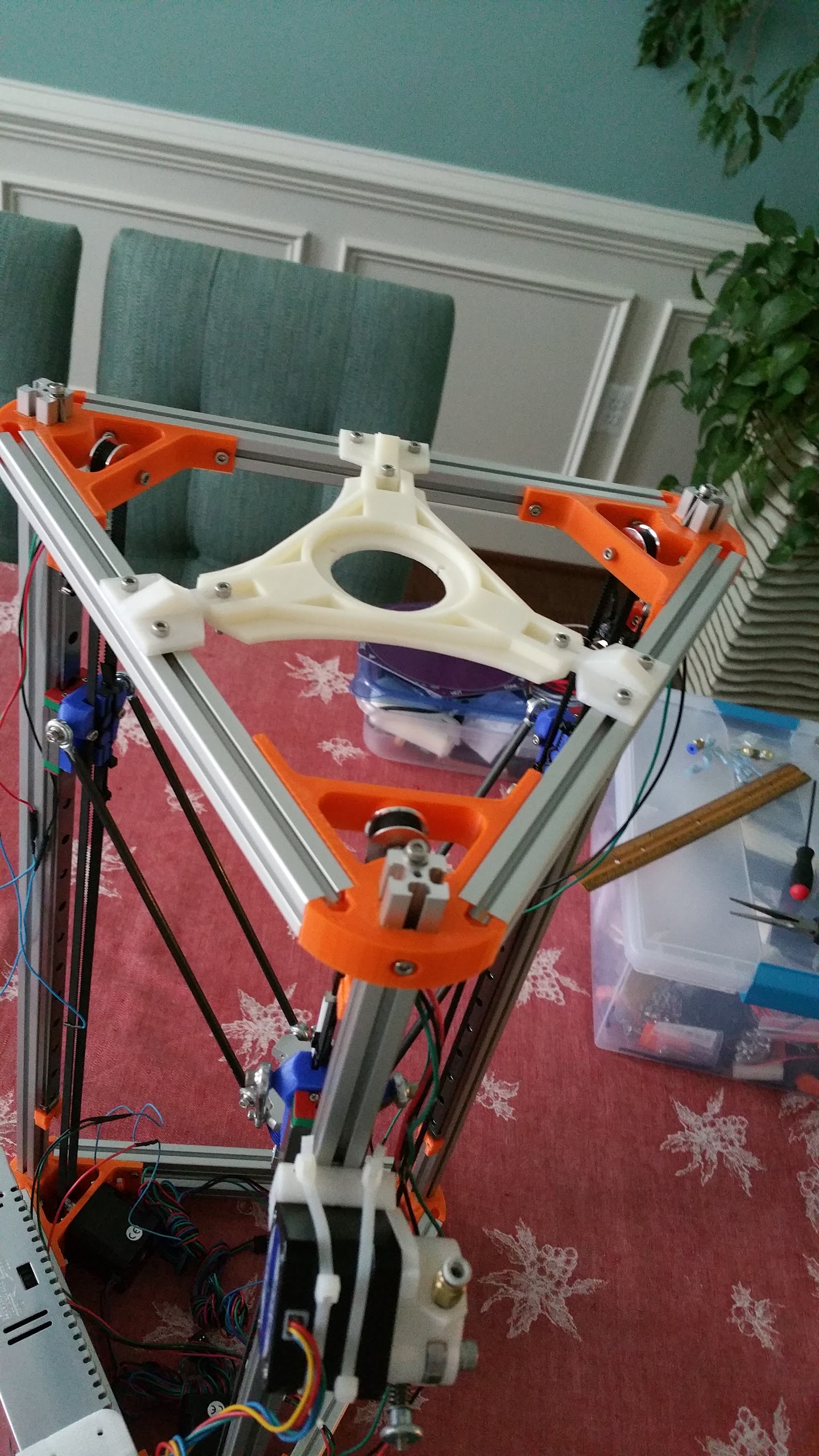

The Delta Mini is progressing well.
The Delta Mini is progressing well. I have to pause now and record a module for PluralSight since I now am waiting on an aluminum heatbed (need that for the inductive sensor). This Delta is actually #2 of 6, with 2 more Minis waiting to join the other full Deltas. Left to do is the wiring to the board, installing the Bowden tube and heater core, mount and wire up the power supply, and install the LCD. I had hoped to be done long before but holiday festivities overtook me. I also need to find a way to remove the spindle in some old hard drives since one of them goes on the filament reel mount, which you see in these photos.

I like that top brace
@Griffin_Paquette it is http://www.thingiverse.com/thing:371881
I am now looking at replacing the Bowden Extruder with a micro extruder like this one from Ultibots: http://www.thingiverse.com/thing:266711. What do you all think? It does mean that I can print flexibles of course, but it does mean removing the Bowden. I also have an authentic Josef Prusa all metal hot end, that is tiny (and I do mean tiny) that I can use…Anyway, thoughts?

I should take another photo. Since I did this, the inductive sensor arrived, the power supply has been mounted and I printed a case for the controller. All that’s left now is wiring. Oh in terms of parts: hot bed if you want to really get good adhesion, an inductive sensor if you want to not have to keep hand leveling and end stop switches (I pull those, and all sorts of rods off dead inkjet printers). I also have seen carriages that use DIY store roller wheels instead of the linear rails that I have. Finally belts and pulleys. Collect the parts slowly, or look at +Shauki B’s leadscrew Delta. Far fewer parts and super rigid – that’s next on my build queue. You can also buy a Chinese Delta for very little, then have Jinx print you up any part replacements and Bob’s your Uncle.

I also suggest printing the plate patterns on paper, then tape to 6mm polycarbonate sheet of suitable size acquired locally, then drill your holes. You don’t really need to cut a triangle and if you do it this way you can build walls around the whole thing and totally enclose it. Total machining cost = zero
