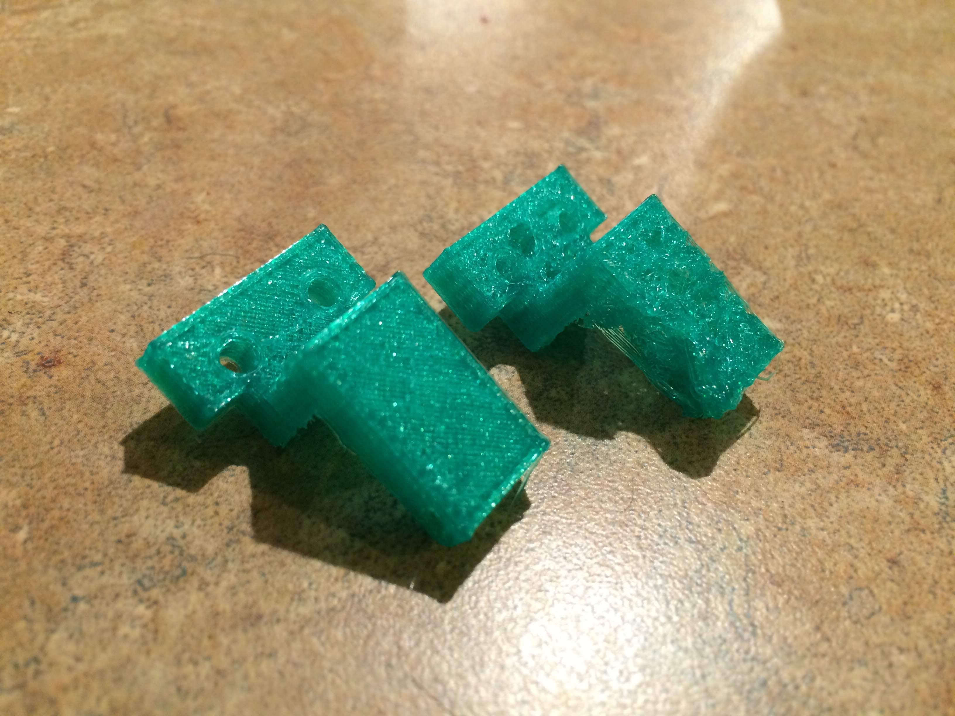

The difference between active cooling and no active cooling
What exactly is active/non-active cooling?
A seperate fan blowing on the parts of the print that have already been printed. Essentially, you want PLA to be cold…hot for a very short period of time, then cold as fast as possible again.
