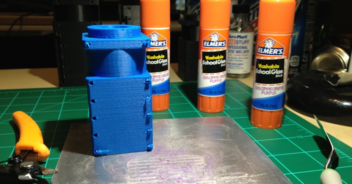

The Elmer's washable school glue stick disappearing purple increases adhesion to the 3d printing
The Elmer’s washable school glue stick disappearing purple increases adhesion to the 3d printing build platform to the object being printed. It is very easy to use and you can wash it off with water.
Is this printing in ABS, PLA or something more exotic?
Just ABS, I have seen videos of people using the same trick with nylon and PLA
