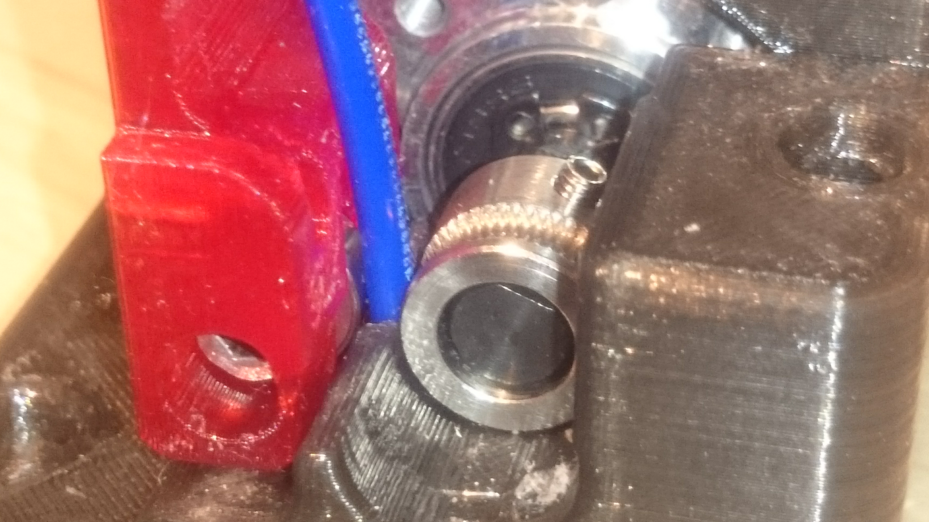

This is a view on my extruder. Can print ninjaflex through a 0.4 nozzle with 0.8 extrusionwidth at 40mm/s @ 0.2mm layerheight which is quite impressive i think. No PTFE liner or such.
But to be fair its 2.85mm filament ;D

That 3mm can print flex more reliably isn’t huge news but you need a heavier motor to do that, I see that’s a metal gearboxed motor. The Flexion is goofy for not being more universal. I wondered before if their 4 pressure settings was enough, sounds like it isn’t.
