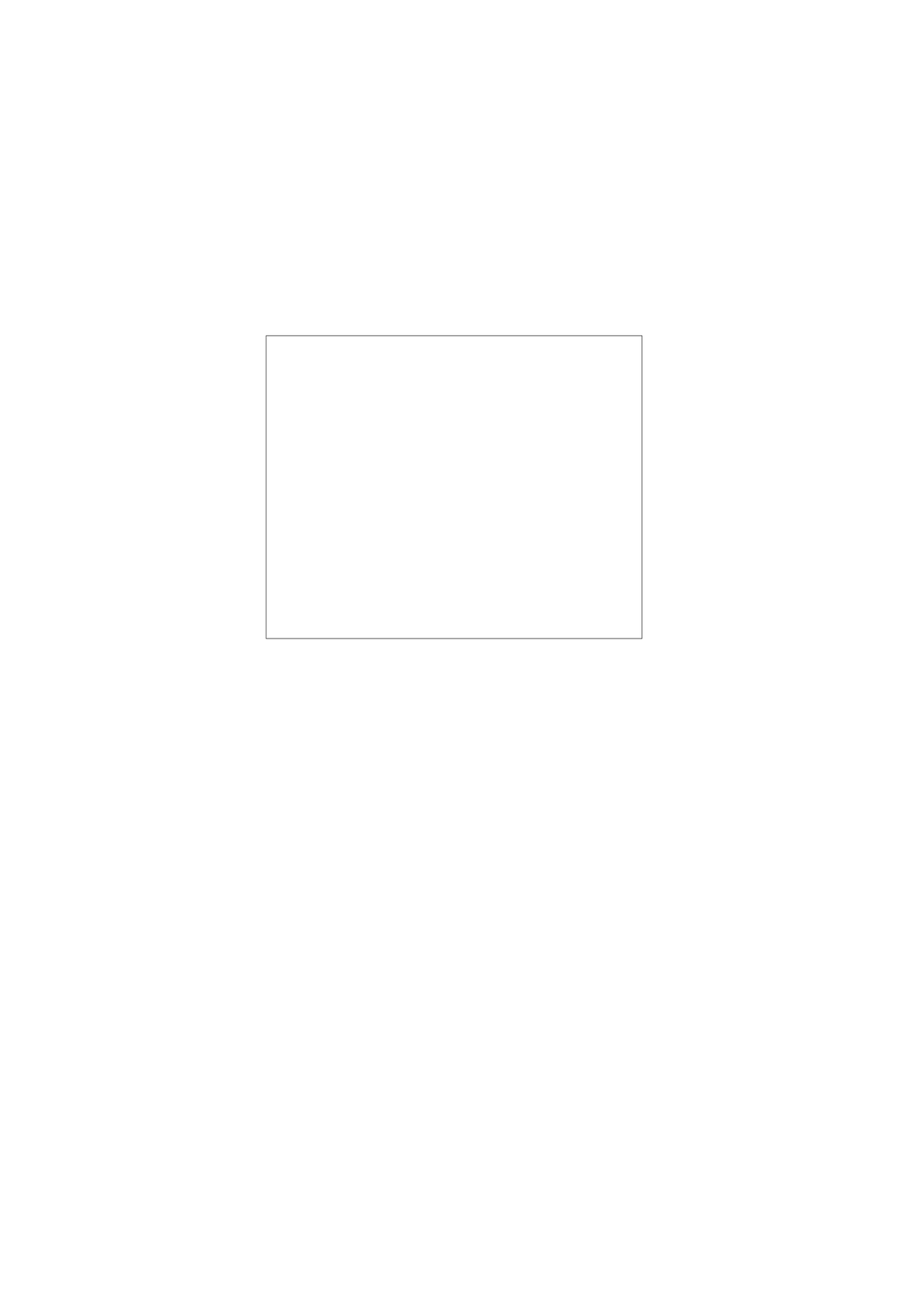

Here’s a test svg from Inkscape. Try loading and converting that in LW.
@Kenneth_McCall I loaded it and it opens a rectangle shape. I do get the error you are talking about but it doesn’t seem to be an issue. Also, your rectangle was not converted to a path in Inkscape. Check this post as it states that if you get this error, don’t worry about it unless your file doesn’t actually load correctly. https://plus.google.com/111661714770079378479/posts/W7jsKQhS7EX
@Arion_McCartney Converting object to path and stroke to path comes up with the same error. The problem is that I can’t convert the SVG to gcode, so the feature ends up being useless…
