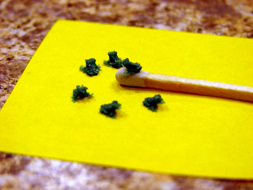

The first 2 mm tree frogs on a Printrbot with a prototype 0.10 mm http://www.jerrill.com nozzle. Retraction and bridging settings still need a lot of work.
dude this stuff is insane.
does a nozzle that size require heavier torqued extruders?
I’m just using the stock NEMA 17 steppers that came with the Printrbot Plus running at 5 mm/sec to 20 mm/sec on the smaller nozzles and haven’t had any problems. The back pressure is pretty high though. The drive gear / hobbed bolt has to have really sharp teeth to feed the filament without slipping.
That is just amazing.
Could you print something larger so we can see how the nozzle is performing? These are kind of fuzzy and I’m wondering if it’s because your X/Y isn’t insanely perfect enough for this, or because that tiny nozzle oozes or something.
It seems like it shouldn’t ooze with such a tiny hole.
