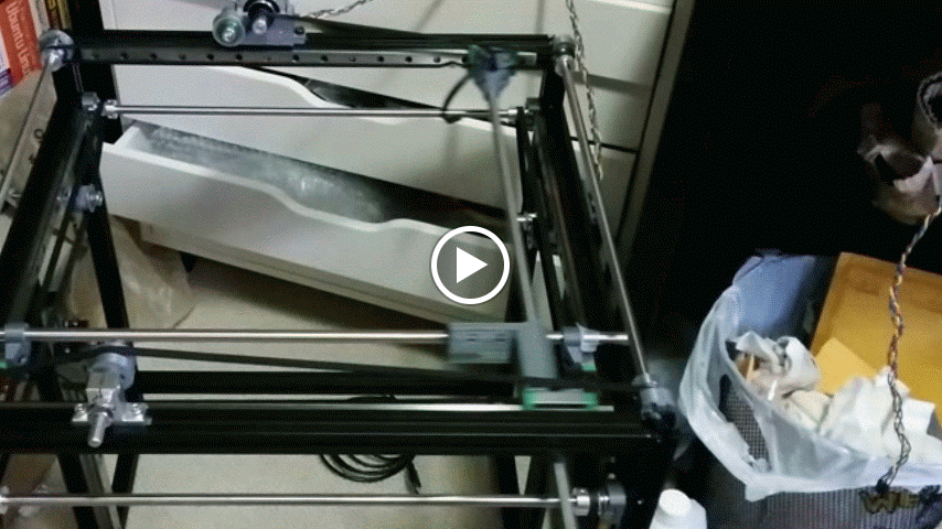

The first automated moves on my new printer, which I am calling “Machigai” . Machigai is Japanese for “Mistake”, as I have made many during the design of this printer. The frame and basic design is from the Ingentis, but I am using linear rails for all axes. Inspiration was taken from many places to design the mounts, but they are of my own design, so when they fail, I have no one else to blame.
Only X and Y at the moment, but it seems to be working well. I am borrowing the board from my Cupcake here, just for testing purposes.
Can’t wait to get my Azteeg X5 next month, by which time I should have the rest of the printer designed and working. Still lots of work to be done, but that’s where the fun is…
