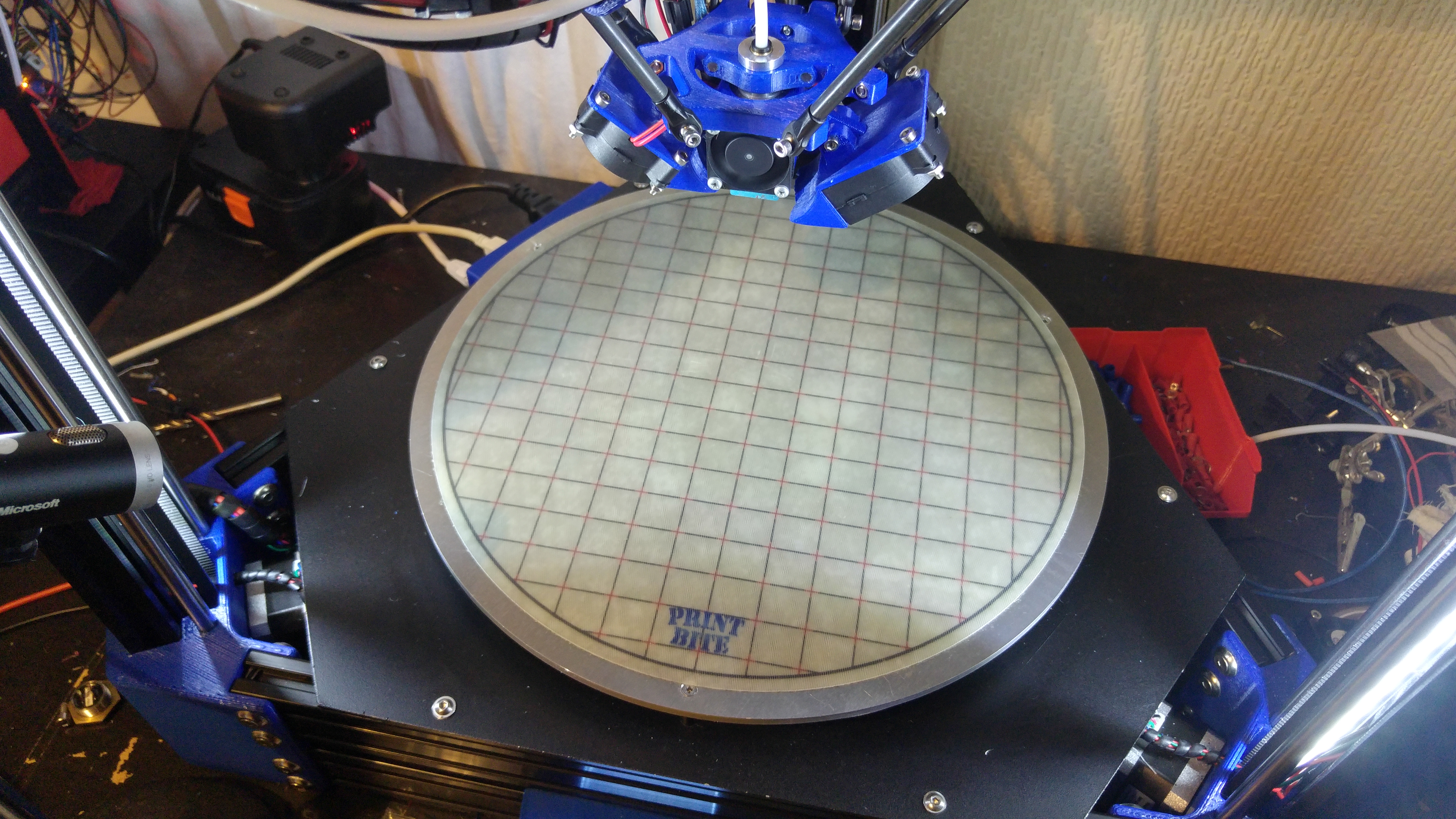

The #AX-02 got it’s final print surface today. #Printbite by Flex3Drive / @Mutley3D
Love this stuff, permanent surface and very low maintenance. Just wipe down with soapy water when cold if stuff stops sticking and away you go.

Nice to see you found something that works for you. Happy printing!
How does it compare to PEI? I like my PEI for PLA but abs seems a bit more hit/miss
Can’t compare as I’ve never used PEI. Unless you import PEI for 3D printing is a pain to get hold of here in the UK. That being said ABS sticks well.
