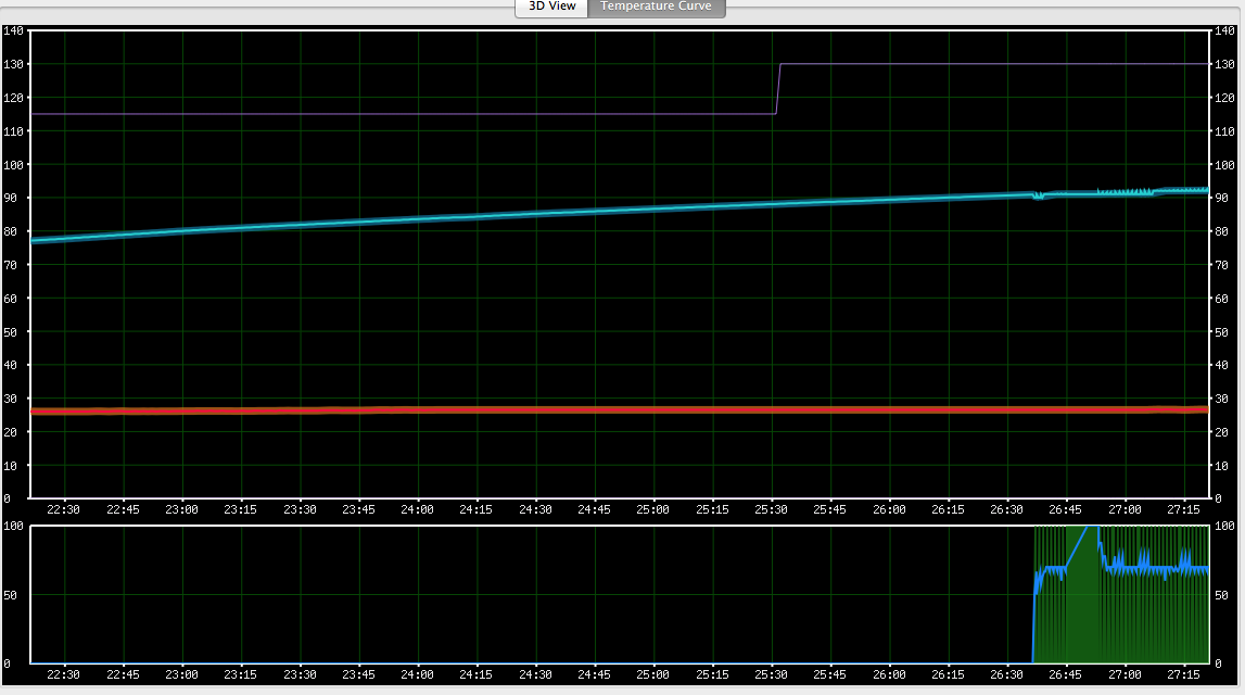

The heated bed does not reach the desired temperature.
The heated bed does not reach the desired temperature. Any ideas why this would happen? Everything is connected well and the firmware settings have not changed to my knowledge.

That’s true :slight_smile: I cranked the voltage up to 14 (The highest that my supply will allow) and nothing changed. It still drifts off like this and never gets to 115. It worked fine until all of a sudden it wouldnt go. Not sure what is wrong. The thermistor is working, everything is hooked up. Im still tinkering though
