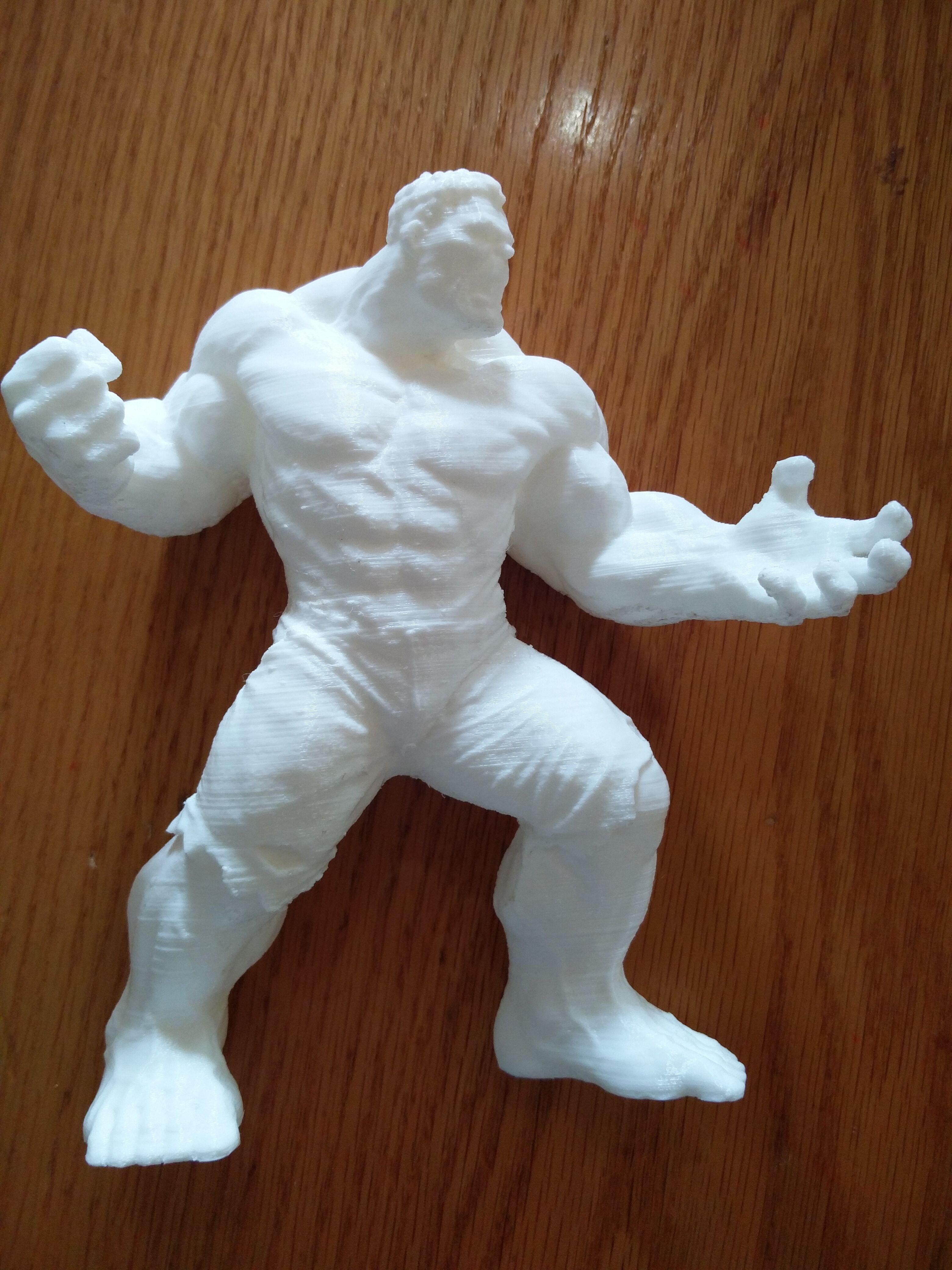

The Hulk Cleaned up Next is sanding and painting.
The Hulk Cleaned up

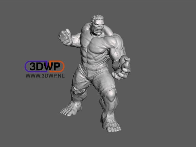

Cool. Where’d you get the model?
@Chris_Harpner_CSharp probably thingiverse. I know they have some hulk models on there.
Yep, looks like this might be it:
It’s exactly that one with the modeled tree supports…
Now that was difficult to remove!
How did you orient it for printing? Standing up?
Standing Up…
@Panayiotis_Savva would you print it again and use your own supports?
I could… In thinking to use normal supports in Cura.
I’m going to have to try this one. 14" tall. :slight_smile:
@Jeff_Parish same but can only make it 12cm, shy 5". How can I cut it and make bigger?
@Lazarus_Long I’d try cutting in half at the waist. Turn the legs upside down.
In Cura you can cut off the bottom (sink the print into the bed) and print the upper half with minimal supports. Turn the model upside down and then sink it into the bed to the same match line and print the legs. For me no support required on the legs.
