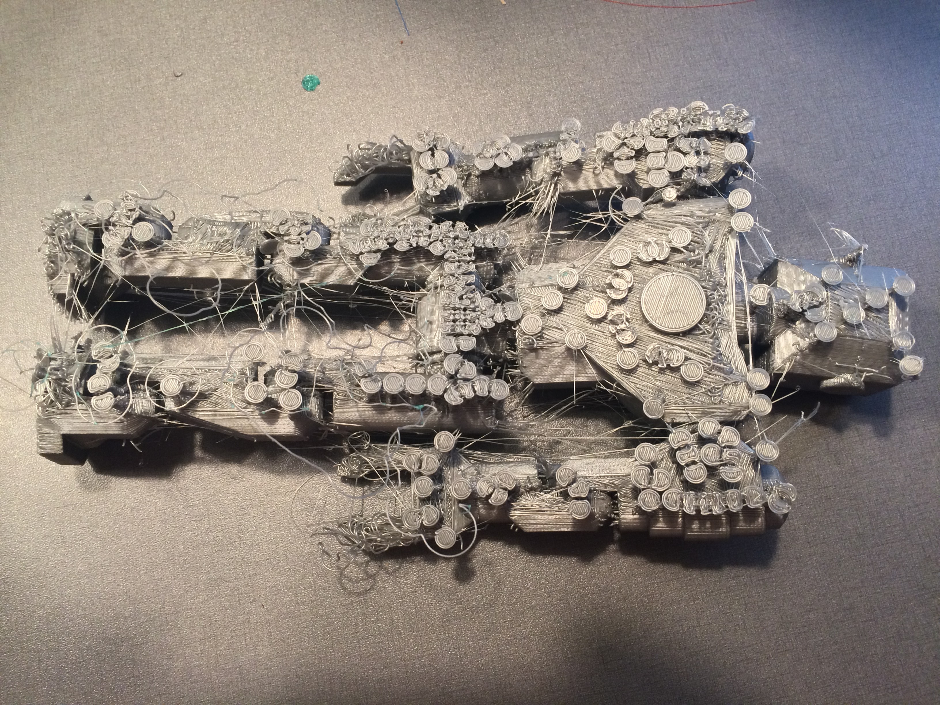

The kids built a new robot in 123D Design yesterday and we tried to
The kids built a new robot in 123D Design yesterday and we tried to to print it using MeshMixer magic strut support. It is like printing on a spike bed :slight_smile:
All the pieces of the robot weren’t joined together so we ended qup with 4 parts and we are going to do another test later today. Perhaps standing up instead?

I can’t help you with 123d but with meshmixer, you would be better off orienting the model at 45 degrees to the bed so you don’t have all that flat surface parallel to the bed that will need to be supported. You may also want to increase the width and density of the support struts.
Your kids modeled that robot from scratch? I’m impressed!
@Tim_Rastall ahh I thought that was a bug in the program trying to print at that angle when doing “optimal optimization”. Anyhow, now I am printing one standing up with supports. About 40% done and it looks good.
