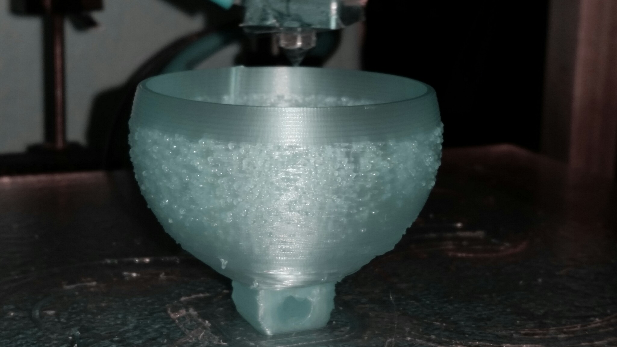

The laptop I print from is a atom netbook. appart from taking a while to slice I never thought it was under powered. I had to have a go at the chrismas baubles on thingyverse I had to see if I could replicate the shiny outer surface. To say I struggled with it is a understatement. I switched to slic3r and about half way throught I noticed it wasn’t going well. Guess where I minimised repetier so the machine didnt have to render the preview anymore. Its around that point I decided its tome for a better laptop to print from.
Quick question: can anyone tell me (Before I sacrifice a core i5 laptop to my printer) if I loaded linux on the netbook would it manage resources better for printing?

The transition from rough to smooth happened as I minimised the display. I never thought it would be the laptop either. Dedicating a laptop to the printer is not that far out for me. I have a computer company and the only thing I have more of laying around than old pc’s is old printers (A4 not 3D) the laptop im thinking of is a working i5 4gb ram etc but had a broken lcd so with rdp access it would be an acceptable solution for me. The RPi Octoprint option sound very tempting aswell. My other printers have lcd displays with SD but ive never bothered with them. I keepsgiving me sd init fail so I may give that some attention to get it going. My first thing to try will however be using pronterface to see what happenes. I use it on my big printer all the time and its installed on the netbook so easiest to go with.

I ended up setting the printer to print from SD card… MUCH BETTER wow cant believe the difference
