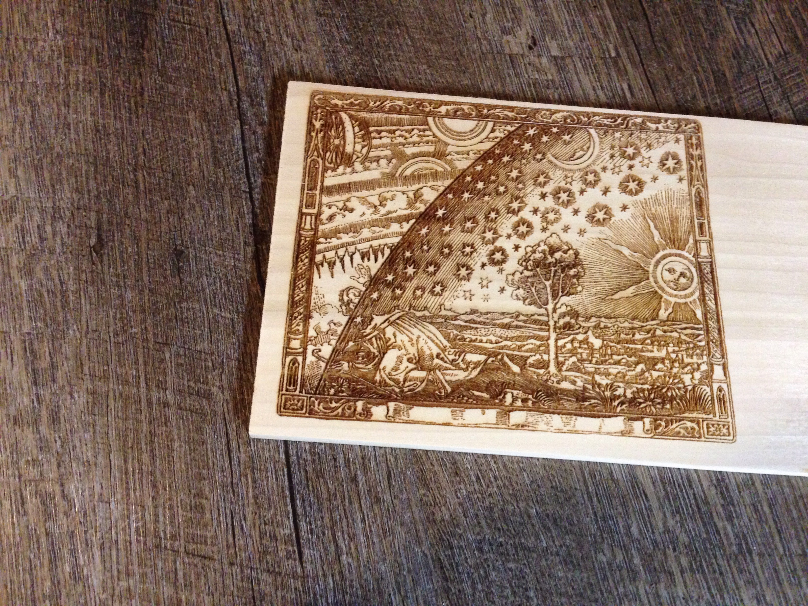

The largest engraving I’ve done so far, ~160mm x 130mm. 7mA@400mm/s.
That turned out wonderful. Is this with stock hard/software or have you switched to LaserWeb?
Air assist + new lens, otherwise stock hardware. Corel X5 + stock CorelLasr.
I realized after I did it that I forgot to adjust the height, I had it set for 3mm but this was 1/4". So it probably could have been a little crisper, but still looks pretty good.

One of my favourite pictures, I’ll have to make one for myself now. Thanks for sharing, David.
