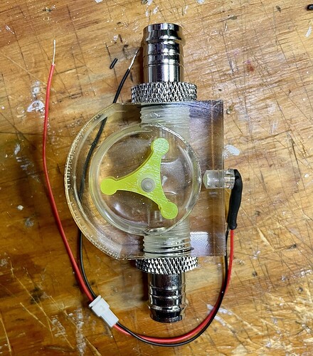

Some like this one also have a 3rd port for a temp sensor and come with a display.

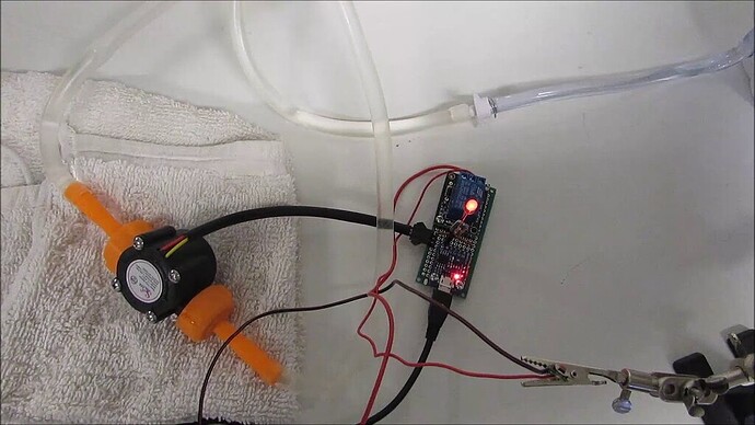

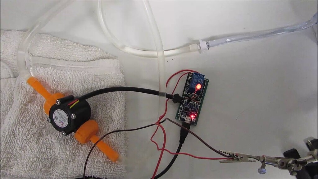

What is oxymoronic is that I did do this proof of concept for when flow does stop but never did interface it with my lasers.

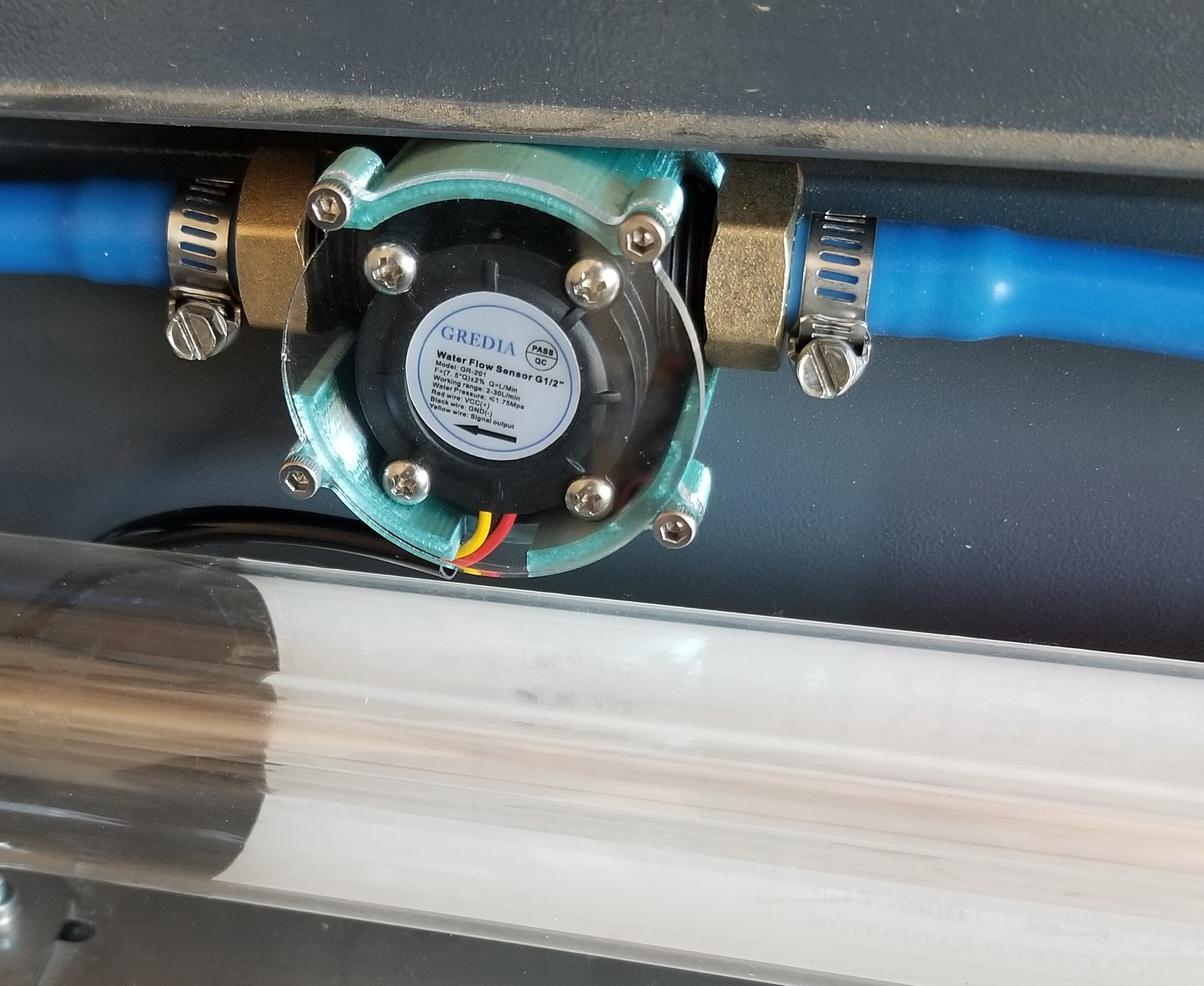

I also have a flow meter. Which looks similar to @HalfNormal device. I 3d printed a mount and put it in the laser.
Had an Arduino initially reading/displaying the liters/min flow rate. I’m currently moving it over to the Pi 4 along with the other controls.

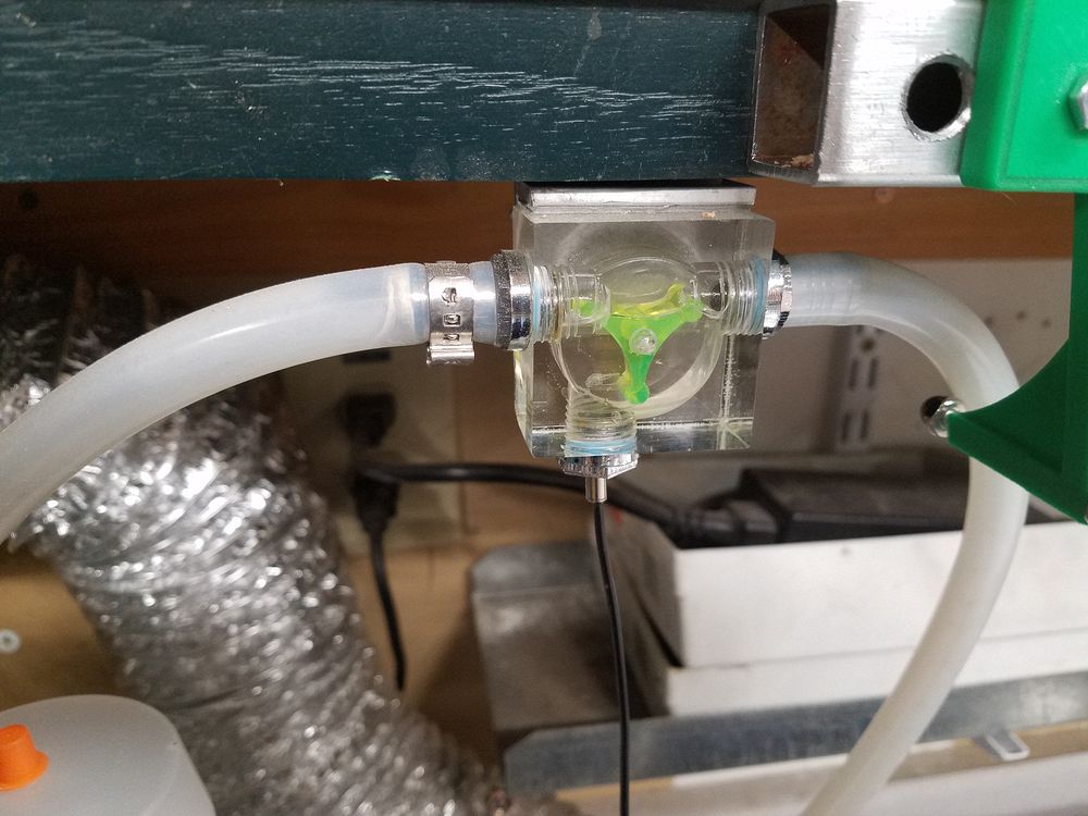

I installed one of those “whirlygig” fish tank flow meters in my return line back to the chiller.
The one I got has a temp sensor in it and has a display:
Display is in the upper left:
If you install a UV diode in that it will glow in the dark. :grin:
No kidding, the one I have really glows. I was doing a garage scorpion inspection with a black light and man!!
