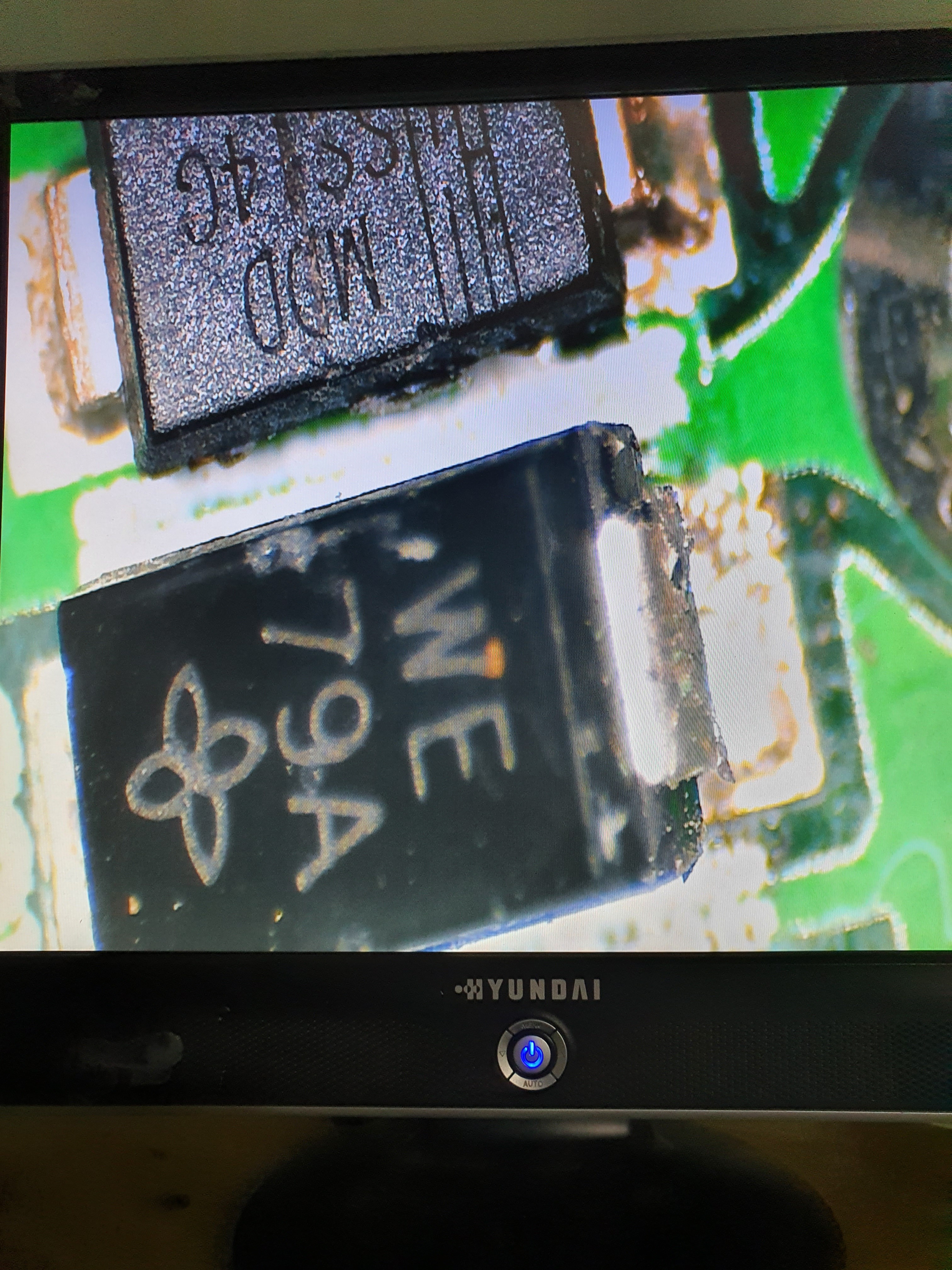

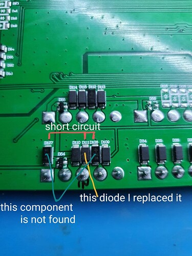

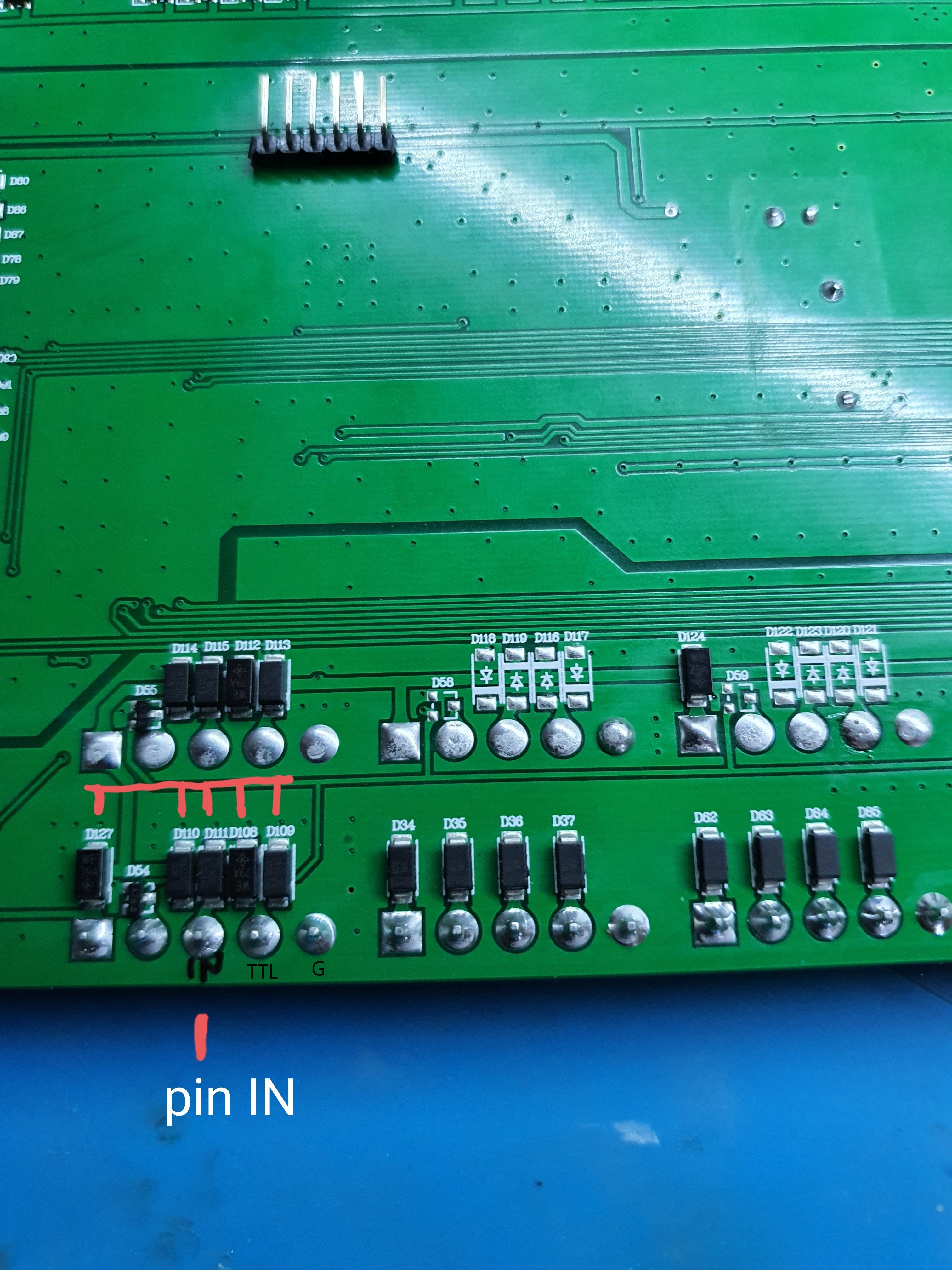

I removed the highlighted components and there are three in short circuit a diode (SS14G) I had it at home and I replaced the other two components (see photo)
WE 79A are short-circuited but I can’t find them
I tried the controller and now the laser fires even with the connector connected that goes from the LPS to the controller but after the first shot it is always on only after the first shot
now i will try to find these components that i could not find on google i asked some shops if they had any but they have yet to answer me
Are you saying that all the diodes D127, D110, D111, D108, D109 are all shorted???
If so that seems quite unusual.

I could not find data sheets for the WE 79A
SS14G.

Did I label the pins correctly in this picture…?
I cannot tell from the picture which side of the diodes is the ANODE
It looks like the two diodes coming from inputs TL and IN are connected together on one end???
Can you tell how the diodes are connected and to what?
Can you draw a circuit diagram?
  • Remove the bad parts and with a meter check where the lands connect to.
  • The input lands should be open
  • The other end of the diode land likely goes to 5V, ground or another diode.
I am guessing these are snubber diodes if so we can probably find substitutes.

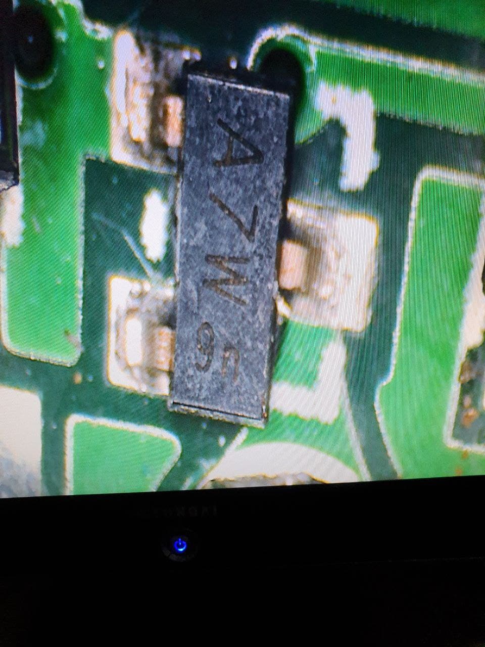

You could try the laser with all the bad diodes removed but I worry about what the purpose of D54 is!
Can you tell the part # of D54.
When you removed the diodes did they read “shorted” when out of the circuit?

I tried with the components disconnected from the board except D54 (diode A7W) and the laser works but after the first touch on the test icon of the control panel the laser is always on

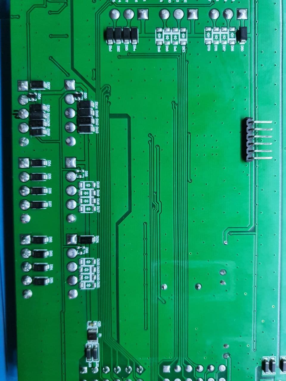

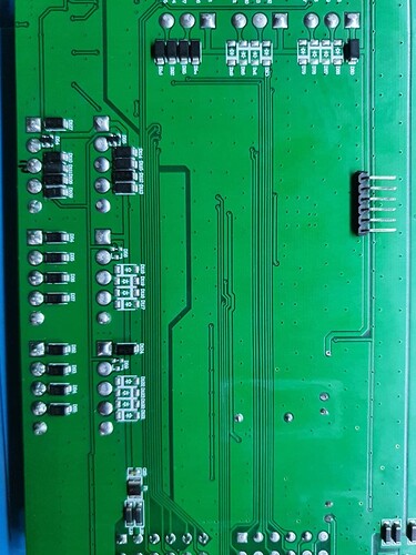

We need to figure out how those diodes are connected.
Can you take a picture of the PCB without the shorted diodes so I can see the lands?
Can you trace the circuit with a DVM on ohms?
