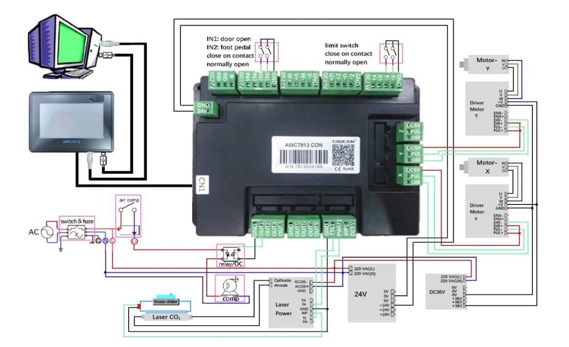

today I moved the connector on the trocen awz 7813 controller to another controller port (attached photo before it was in 1 after today moved in 2) and if I press the test button on the power supply the laser turns on but when I close the laser cover the laser is always on G and P are connected to the interlocks but when I open them they keep the laser on I do not understand what happened I have searched for information but I have not found solutions

This is a K40? Did it come with this controller?
no the original controller is LIHUIYU M2 Nano
what do you say Donkjr I burned the controller?
Not saying controller is bad …yet.
Just wondered how this is actually wired since K40’s don’t usually come with this conttroller.
How do you normally do a test fire from the console using this controller?
If you use that method now does the laser fire?
no Donkjr
this controller was bought later
the original controler is LIHUIYU M2 Nano

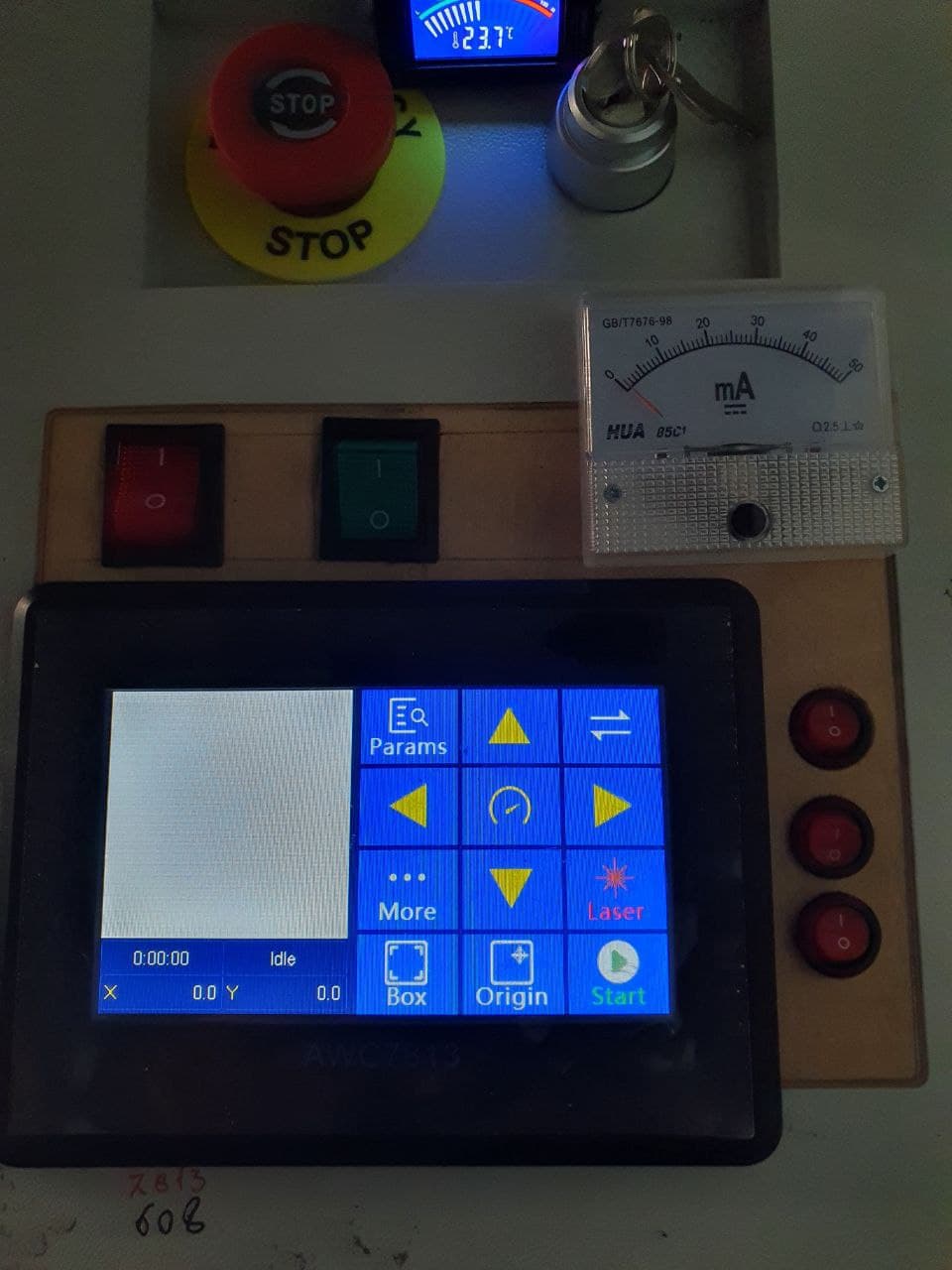

when i press on laser on the screen (see photo) and the lid is closed it does not work the laser does not turn on with plug 1 connected to the controller
As a check,
-this used to work?
-If so what changed between when it worked and when it stopped working?
What is the Power set to in the “Power Area” of the display?
- Power min setting = ???
- Power max setting = ???

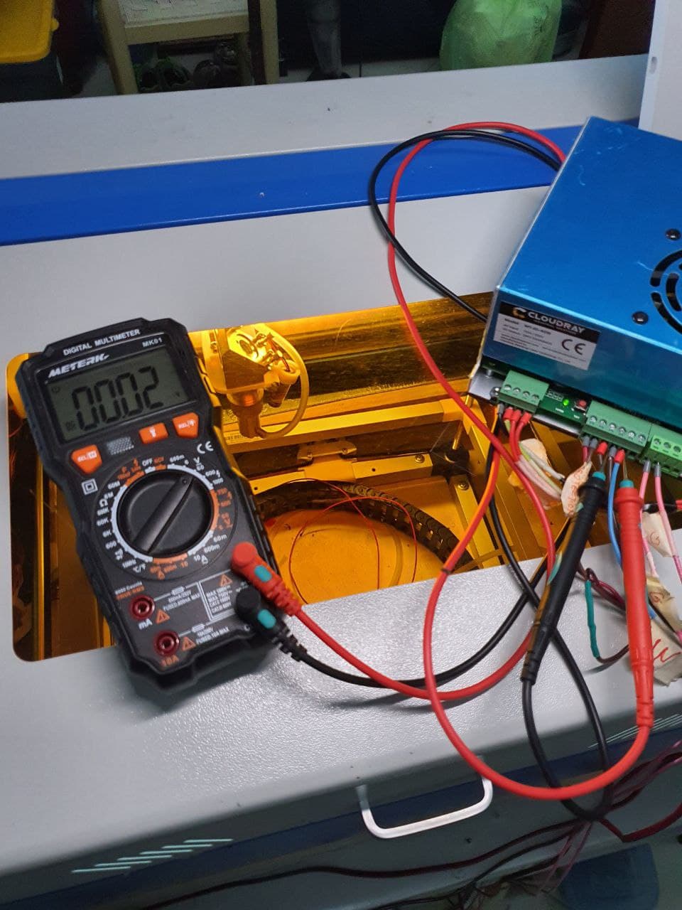

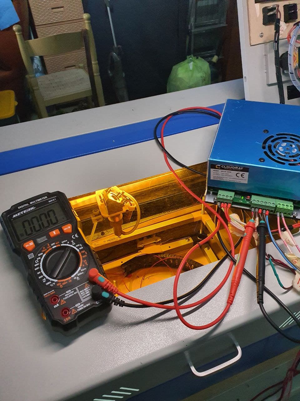

Test #1 Setup
Turn off the machine.
Connect your DVM as such:
- Common probe (black) to the GND pin on the LPS.
- Probe (red) to the “IN” pin on the LPS.
- Set meter to read Volts on a scale that will read 5vdc *
Test#1
- Turn on the machine
- Set the power to 100%
- Ensure all covers are closed
- Push the LASER button on the panel while watching the DVM.
- It should read about 5vdc while the button is pushed
Test#2 Setup
- Common (black) to the GND pin on the LPS.
- Probe (red) to the “TL” pin on the LPS.
Test#2
- It should read about 0vdc while the button is pushed
*Post a picture of the front of the meter (DVM) you are using so we can ensure we are giving the right setup instructions.
Test #1 Setup
Test #2 Setup
when I touch the test button on the panel nothing happens in both tests Test #1 Setup Test #2 Setup

What does the voltage read on TL of the LPS? [read with DVM from ground to the TL pin]
- With power on.
- No buttons pushed
from ground to pin TL the DVM reads (0000) zero with or without touching the laser touch button on the control panel

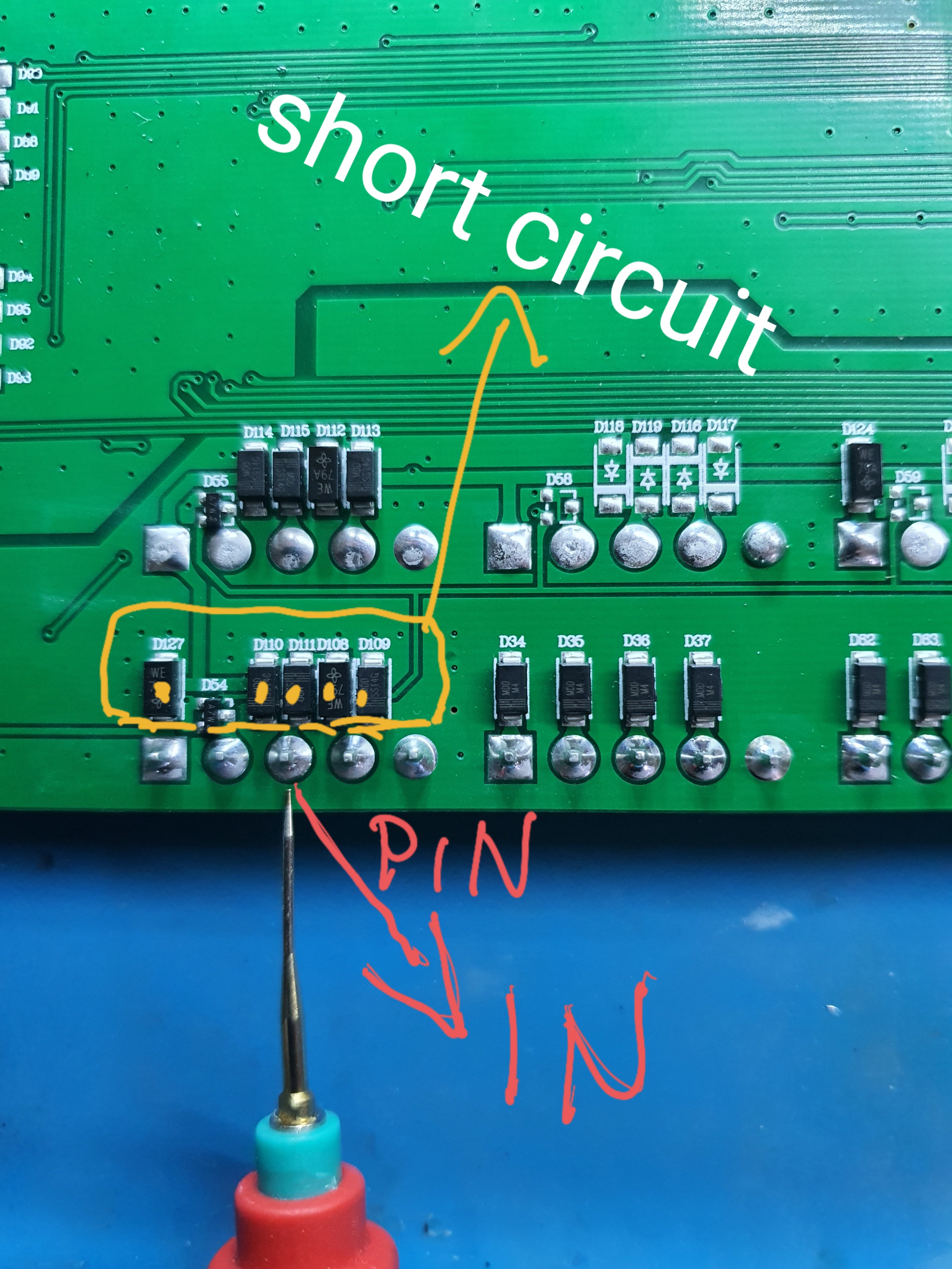

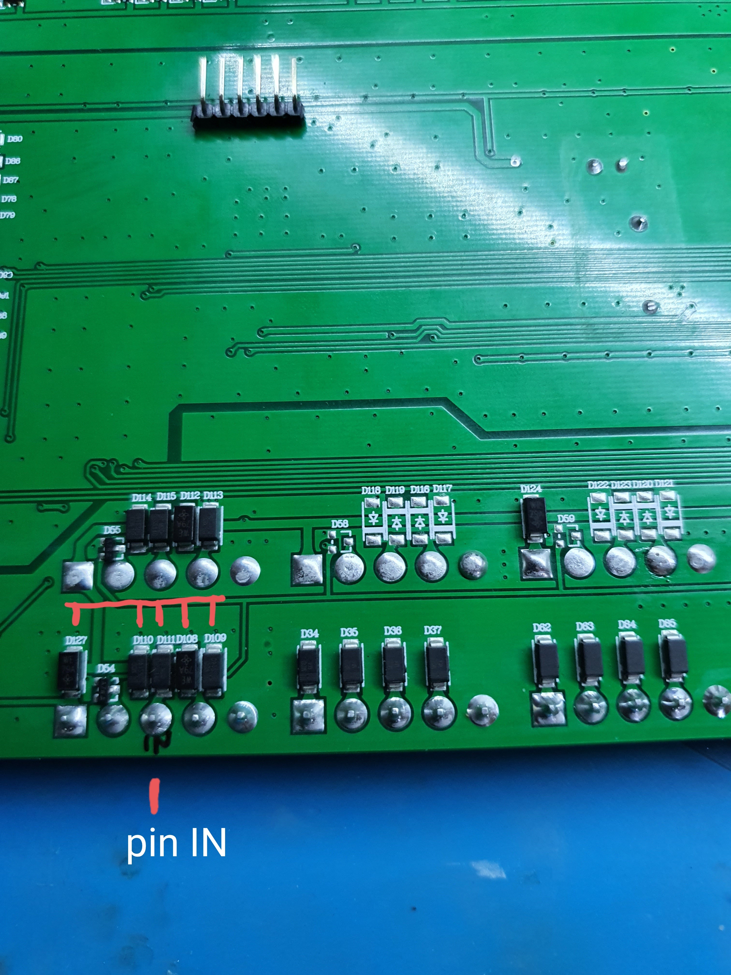

I disassembled the controller I tested the components marked yellow in the photos and there seems to be a short circuit
if from the controller connector with the GND IN TL wires that from the LSP goes to the controller, I remove the IN wire and try the test button so LSP the laser works
How did you test for a short?
Why do you think you have a short?
Short to what …
I connect one part of the DVM (black) to the negative and with the other tip (red) I touch the components highlighted with the yellow dot and on both sides the DVM plays beeps
all the other components the same instead the DVM only plays on one side
