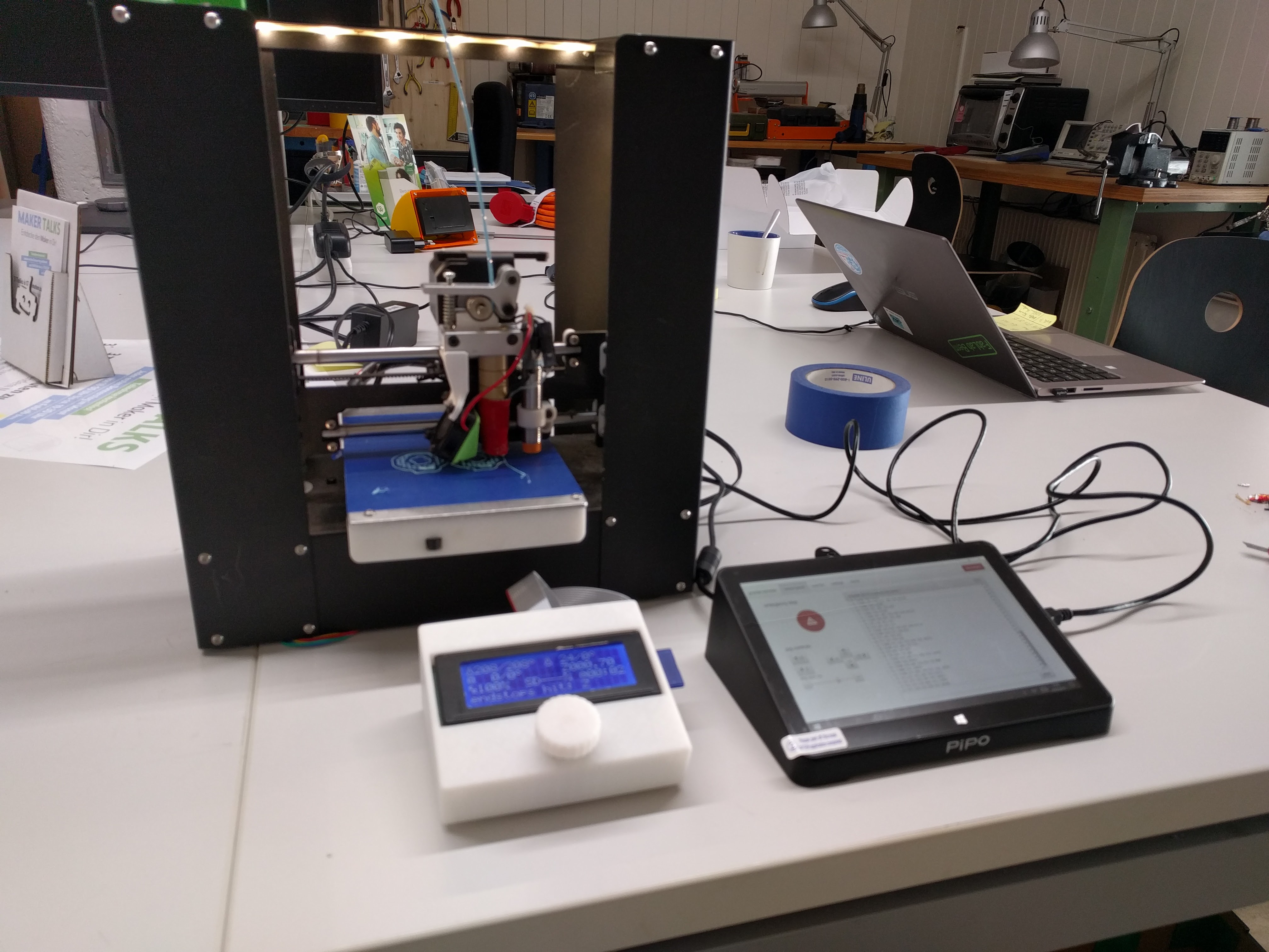

The LCD controller / SD cardreader will soon be replaced by the Pipo (W10
The LCD controller / SD cardreader will soon be replaced by the Pipo (W10 [1]). Now I’m looking for a lightweight GCODE sender (no slicing, no visualisation, just send the code to the Printrboard). Any recommendations?
By now I tried “gcode sender” [2]. But after loading the code it tries to visualize the paths and that is slow on the Pipo. :frowning:
