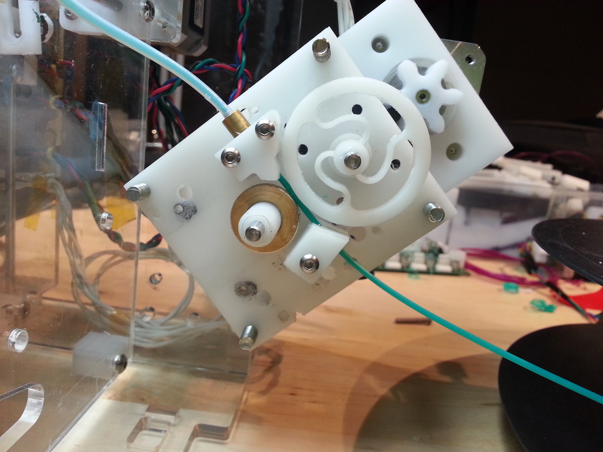

The MakiBox Zen Drive, Production Hotend Heater, and Hot Bed PCB.
The drive, looks like it works really well. Started some prelim tests and calibration. The Betas are going to use a slightly higher gear ratio, which will give a little more kick for short extrusions.
