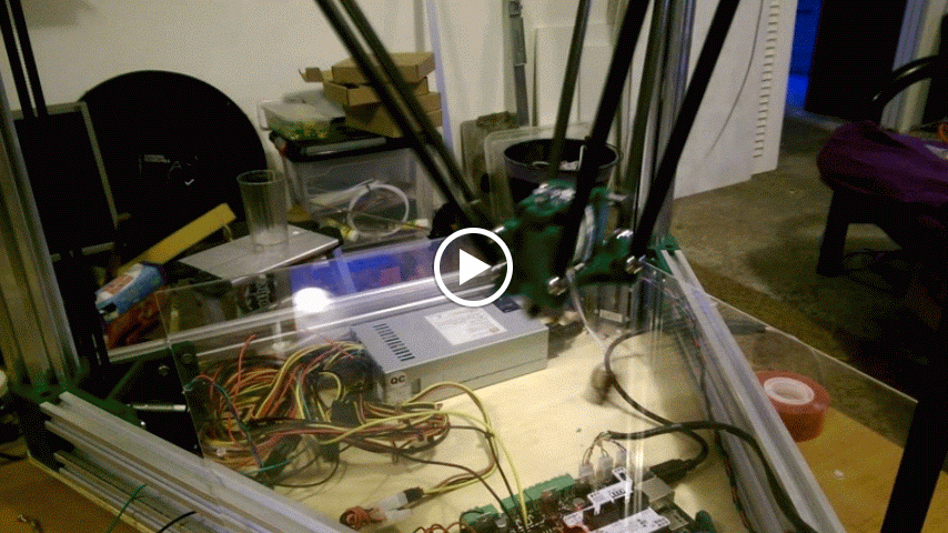

The mega delta printer Electra Flarefire ​and I have been building...
The mega delta printer @Electra_Flarefire ​and I have been building… The question we have is… We know the on board LEDs mean something, but we’re not entirely sure what the combinations mean
Originally shared by Ngarewyrd Shurasae
Quick movement test of the mega delta @Electra_Flarefire ​ and I have been working on. The little dongle is the switch end for the z-probe. We based a lot of the parts on the cherry pi, with a few of our own mods.
Running a smoothieboard for the controller.
Things to do… Extruder, wire up the hot end and fans, then investigate the idea of setting up a heated bed and build area.
So yeah, there you have it, that thing that has been keeping me occupied for a while
And @Arthur_Wolf , who do I thank for the forward planning regarding the 5V rail input diode arrangement. I was trying to work out if it was safe to connect up a 5V always on input(standby from an ATX supply, so we can take advantage of the power switching) with the R-78E-5.0 reg installed… And thanks to the diodes… it is! Yay!
Also… I’d also like to know what the LEDs actually mean… The blink patterns change between idle and printing and look interesting…
