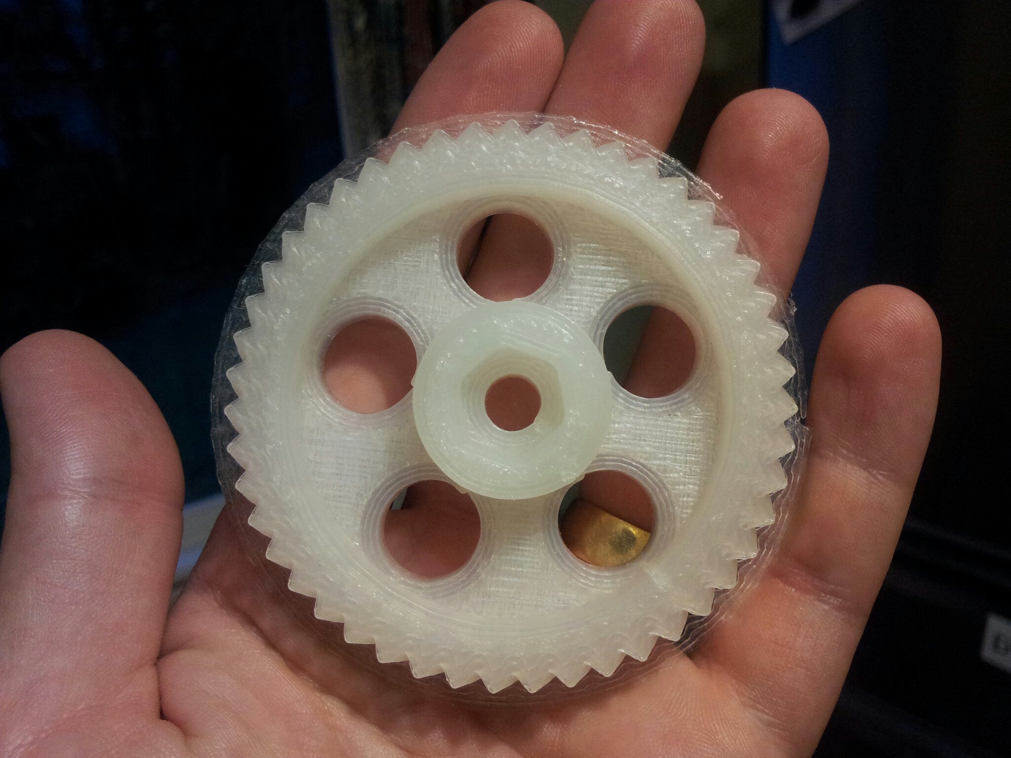

The most perfect, difficult part I’ve ever printed…and in bridge nylon.Friends don’t let friends print at 12V.

@Mihail_MVSmaker This is printed directly from the drying chamber I’ve shown previously with teflon tubing protecting the filament all the way to the extruder so that only 2cm at a time touch the air.
Other settings which may interest you:
3000mm/sec retract acceleration
2100mm/min retract speed
8mm retract
.1mm lift on retract
242C print temperature
E3d hotend
Glass bed with elmers extra strength glue stick
7 loop connecting skirt/brim around the part
Heated bed temperature 45C.
Simplify3D start points adjusted for print speed and all advanced ooze settings on the far right of the advanced tab turned off.
