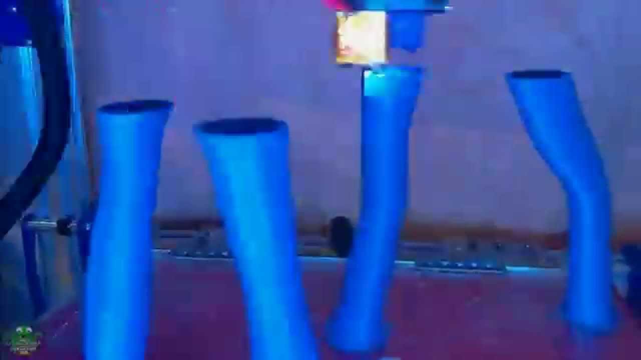

The Mrs. wanted a 3d printed reindeer, so I grabbed the ‘Holiday Christmas Deer’ from Thingiverse: 20" tall, 9 hours print time, 90mm\sec, 300 micron, .6mm nozzle, blue GizmoDorks PLA. Timelapse:
Pretty happy with the surface quality.

I like the “manual supports” at the 7sec mark
Very nice print for those speeds with so much retraction at the top.
I thought it may need a bit of extra support, so I lent a hand
Thats amazing!

Great piece of printing, what actually you did at the 7sec.
I held the end of a metal ratchet under the nozzle as it was extruding, to help it from being unsupported. Looking at the model those angles looked too flat, but I didn’t want to have to generate support… so I just waited until that part started printing and helped ‘manually support’ it
What do you print on?
@Peter_Sharma : I print on glass covered in a 1:1 slurry of water & woodglue. I hit it with hairspray every so often to touch it up.

It’s a custom built “C-Bot”, you can get more info about it on my blog:
http://www.akeric.com/blog/?page_id=3063
How did you get the smooth finishing for PLA?
In all honesty based on the lighting in the pic, and the size of the print make it look smother than it is. Although even in person people content on its smoothness. You can easily see the layer lines up close (it is 300 micron), but the overall quality and consistency is quite good. Which I would attest to the overall corexy design style of the printer, and my obsessive compulsive attitude to tuning print settings
