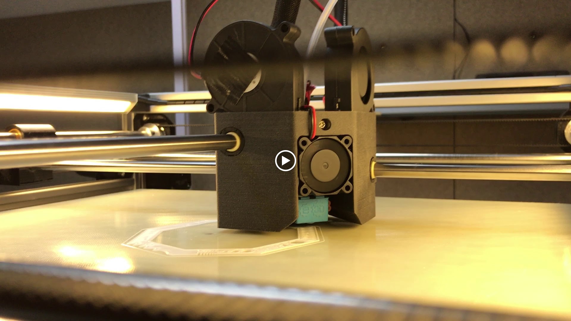

The new carriage is just printing its first layers and it not only looks quite nice but moves quite nice too. I’m happy how this turned out. Didn’t think that my first printed version of the new carriage would fit instantly in all terms - even with the clips for the @igus_Inc ECLM bushings.
The play of the carriage is way lower than with the ball bearings (i would never talk about zero play just because that doesn’t exist g).
