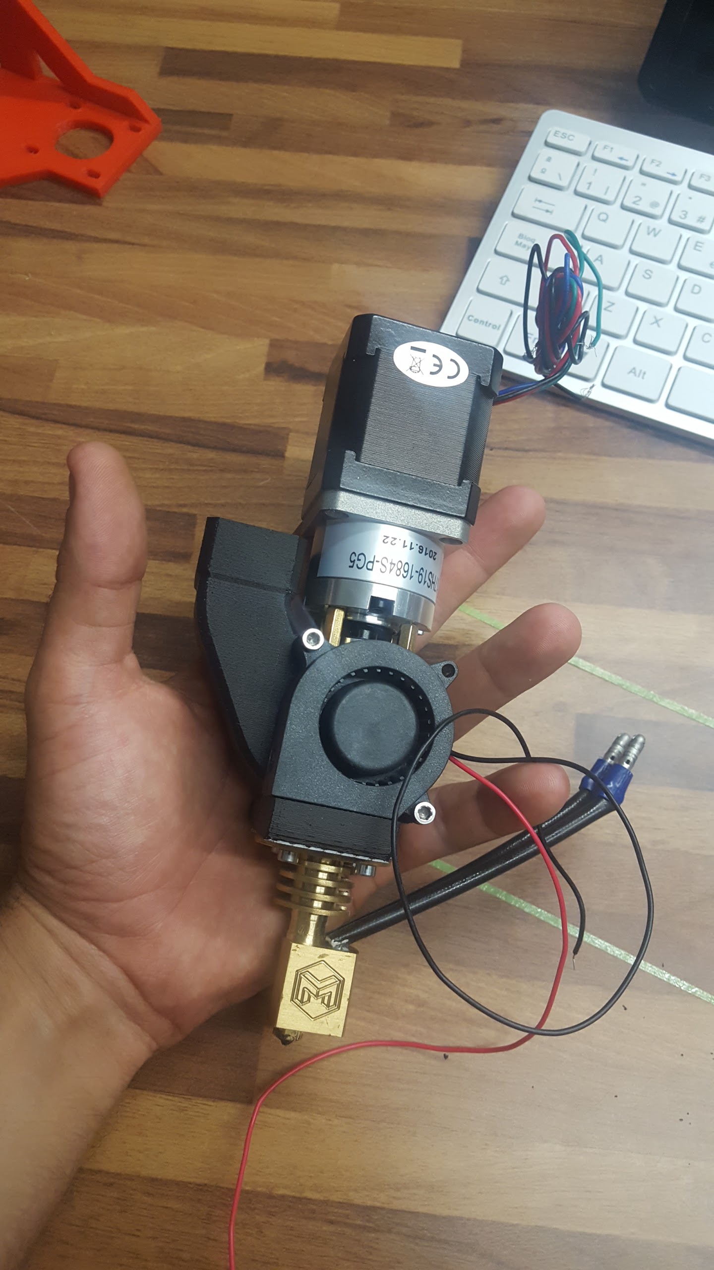

The new design of mahor muñiz cadenas universal pellet extruder has arrived
The new design of @mahor_muniz_cadenas ​ universal pellet extruder has arrived. I think this is interesting for the community.
How well does it work inside a 3d printer?

Basically, you forget about filament and drop a bunch of cheapper plástics pellets???
@lightshadown That’s the basic thought (although I don’t know about the ‘cheaper’ part - if this ever catches on, we’ll probably get another round of ‘up with the price’…). And incidentally this could fix the old problem of recycling failed prints - just run them through a shredder, dump the shreds into the pellets and re-print…
Nice! Basically an open ended (nozzle) plastic injection unit. The diversity of methods to 3D printing is just plain awesome!
Now to precisely time the ingestion of different colors of really fine pellets (6 feeder bins CMYKW+S) for full color FDM printing with support material without all the color change waste. Half joking, would likely produce shades of mud, but it’s still is a cool idea.
As for using recycled plastic in the same process that generated it in the first place the issue of cross linking needs to be taken into consideration even when mixed with new material. Each time a plastic is heated up, melted, and cooled back down you get cross linking which changes the melt temperature (typically raises it) for the next time you try to melt it. After multiple recycles (you have to blend with new material each time) you will have multiple levels of different cross linking in your blend. All it takes is one small melt resistant chunk to plug the nozzle really bad.
With that said you could likely get away with a few recycle rounds before the plastic became unusable.

Just to play devils advocate here: what is the advantage of this system over an separate filament producing device? The disadvantage is your extruder assembly has more mass to support/move and larger objects will require you to refill the hopper mid print.
@Eric_Davies my view…
you can have as light hot end/extruder/effector as you wish, but when it comes to pumping material… i
this is not intended for high details, getting similar quality compared to regular filament is significantly harder in any way… so not for small nozzles.
i see this as solution for 1+mm layers, where amount of filament tips the scale.
retractions should become more manageable, biggest hw worry i see is managing air pockets (guess, not fact)?
why limit this to desktop?
it seems best suited for something like 1m3, but that is just me…
True, but how heavy is too heavy? I’ve bucked the opinion that Bowden is “better” b/c it’s lighter. I’ve always used heavier direct drive on Cartesian printers.
So when does weight negatively affect a Cartesian printer’s speed? And when does weight and slower print speed not make sense for cost savings trade off of pellets? Some value speed over price of ownership. Some, like me, value lower cost of ownership / lower cost of each part over speed and can tolerate a little increased complexity and initial purchase price.
Another question is, are there a group of people willing to tolerate the lower resolution I believe a pellet extruder printer will have? I assume you won’t be able to overcome some of the challenges that pellet extrusion will bring… I don’t think you will be able to control extrusion to the degree that perfect filament with a mature, conventional extruder now enjoys.
Brook
I am mostly interested in pellet extruders as a way to reliably and cheaply print large objects with 1,5mm nozzles and upwards, where it is not about precise deposition of 0.1mm3 volumes but a very large volumetric print speed with decent quality.

Regarding nozzle size, 1.5 is a safe target. We have actually gotten great results with a 2mm tip on 1.75 filament, believe it or not. Pressure builds adequately even at 2mm. :wink:
