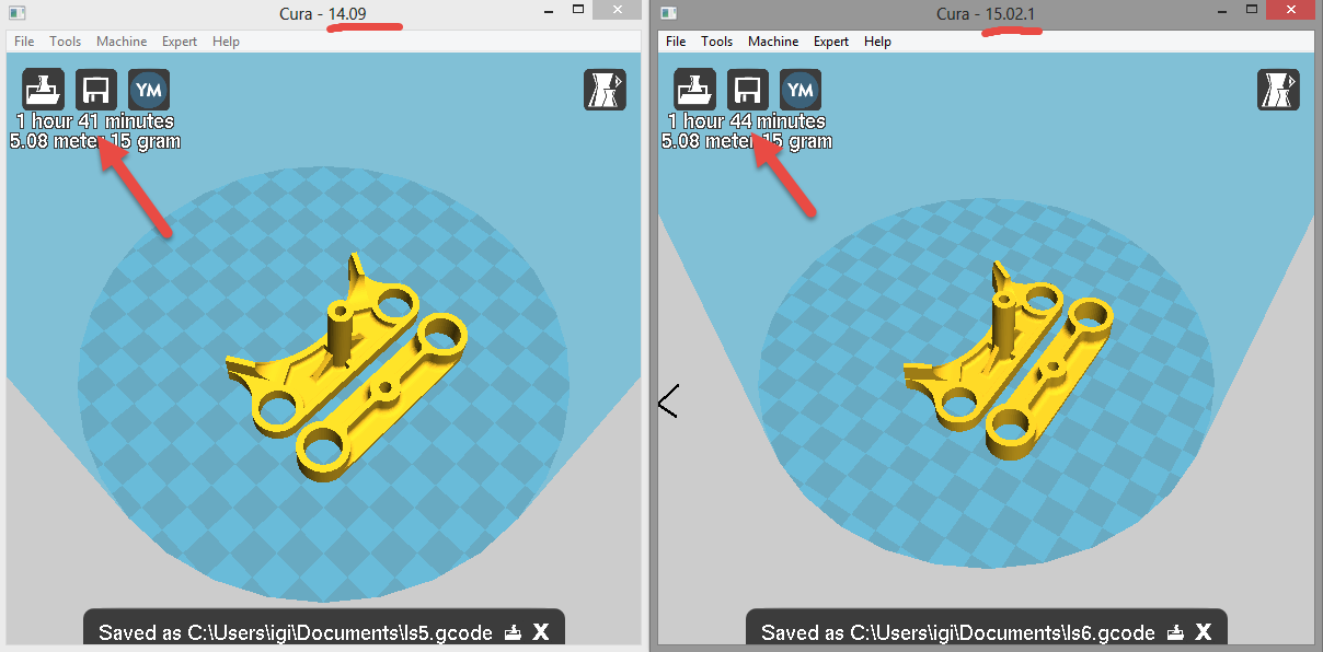

The new 'improved' Cura 15 has some serious issue in slicing engine.
The new ‘improved’ Cura 15 has some serious issue in slicing engine. I checked the number of retracts in gcode: 175 in Cura 14 vs. 602 in Cura 15. With same settings!

So this what one of my layers looks like between the difference versions with the same settings and model.
Imgur
I’m switching back to Cura 14 until they don’t fix this.
