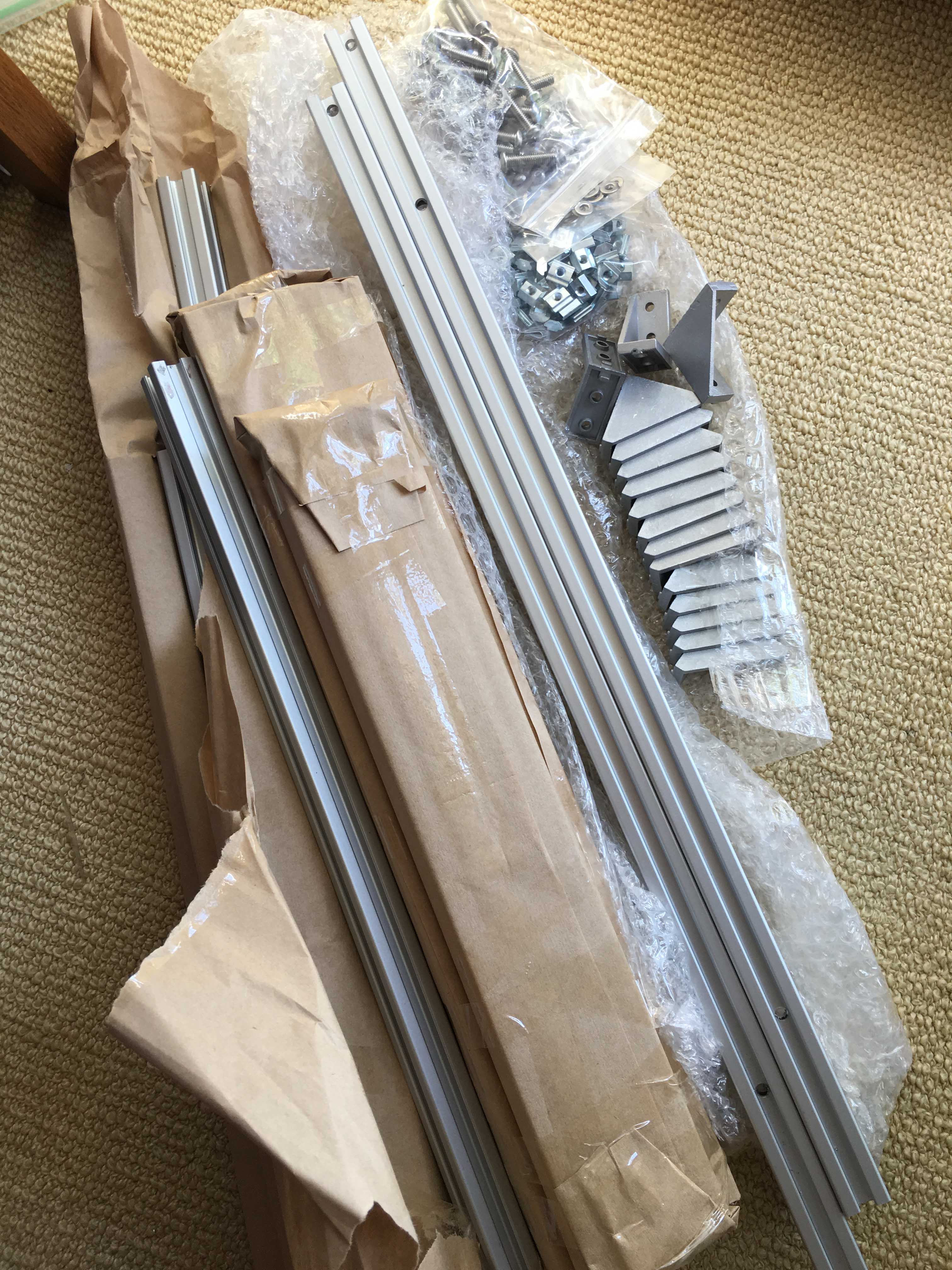

The obligatory first buildlog post. For anyone in NZ looking for a frame I got this from “Mecha4makers” in Wellington. Nice to deal with, good price and very nicely machined. I roughly put the frame together with no corner brackets or tweaking and the top was perfectly square and the bottom was out by 0.5mm so very happy.
