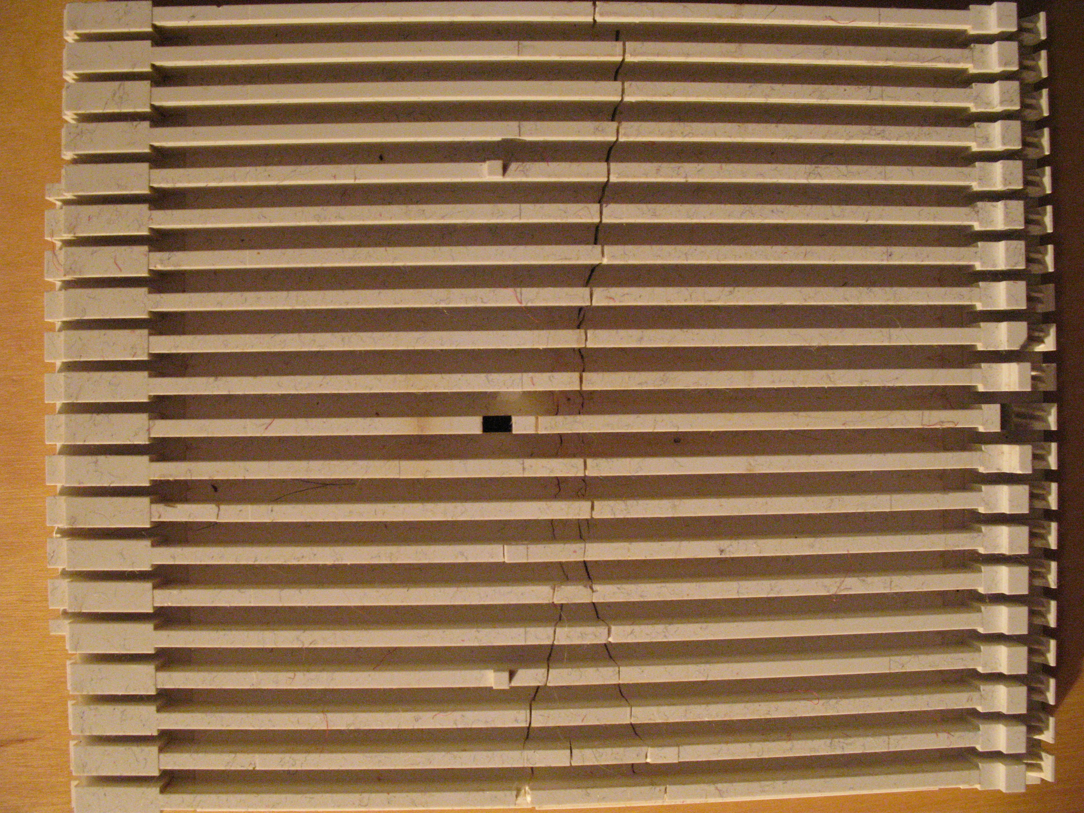

The PASSAP Duomatic 80 knitting machine had to be cleaned after many years of use. Over the years the needle beds cracked and plastic (ABS) started to crumble. New needle beds and a new handle were printed.
Printed with PLA on a BigBuilder and Creality Ender 3, designed with FreeCAD.
