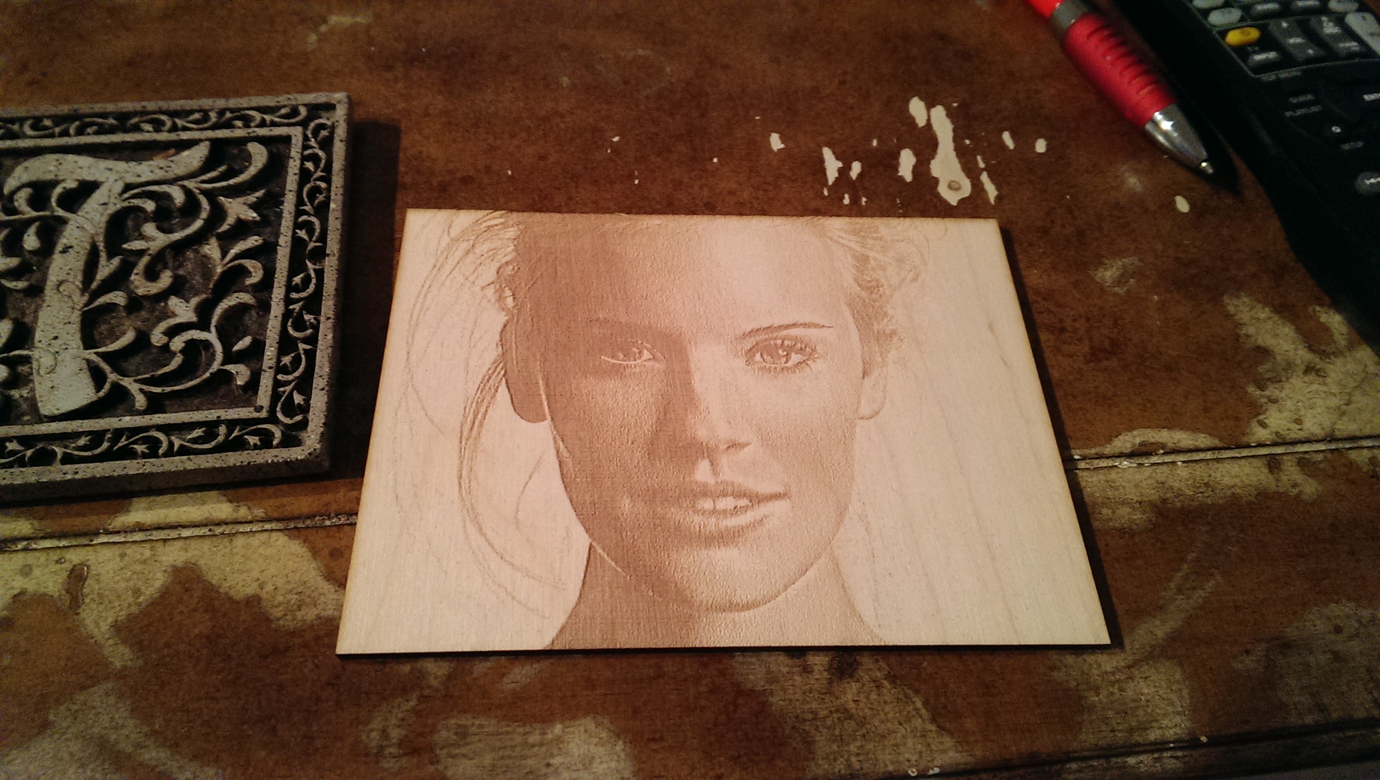

The photo I did today with Photoshop elements…a must have for photos!

What specific workflow did you use?
Photoshop elements 12.
@Scott_Thorne How did you do that, step by step please. What kind of filters etc. Nice engraving!
I’ve had some success with producing half-toned images using inkscapes ‘Create Tiled Clones - Trace’ feature. e.g. https://photos.google.com/share/AF1QipOqksK6bqV4o_5B5XMKyEM9r8DTHe-a8ZXJCv-_dn41dUD9iy0cxaervK83KhMD_g?key=QUFIN1RtRlBIZ3QzODlIN0N2MURnTTRhQ29xel9n
@Michael_Schroeter_Mi …I first used the unsharpen mask…then posterize to darken the shaded areas then converted to greyscale…then converted to bitmap with dithered selected.

Corel is a vector art program, not really meant for bitmaps, so it has limited features there. If you dont have/cant afford photoshop then free software like Gimp will do the job. all the filters mentioned above are standard and can be found in any half decent bitmap editor.
@Justin_Mitchell is right, I bought Photoshop elements 12 on Amazon for 70.00…great price considering its 170 at Wal-Mart’s.
70 bucks is minscule compared to what I have invested in my cnc softwares. I will get PE today. I just need some tutelage as I am not at all familiar with it.
