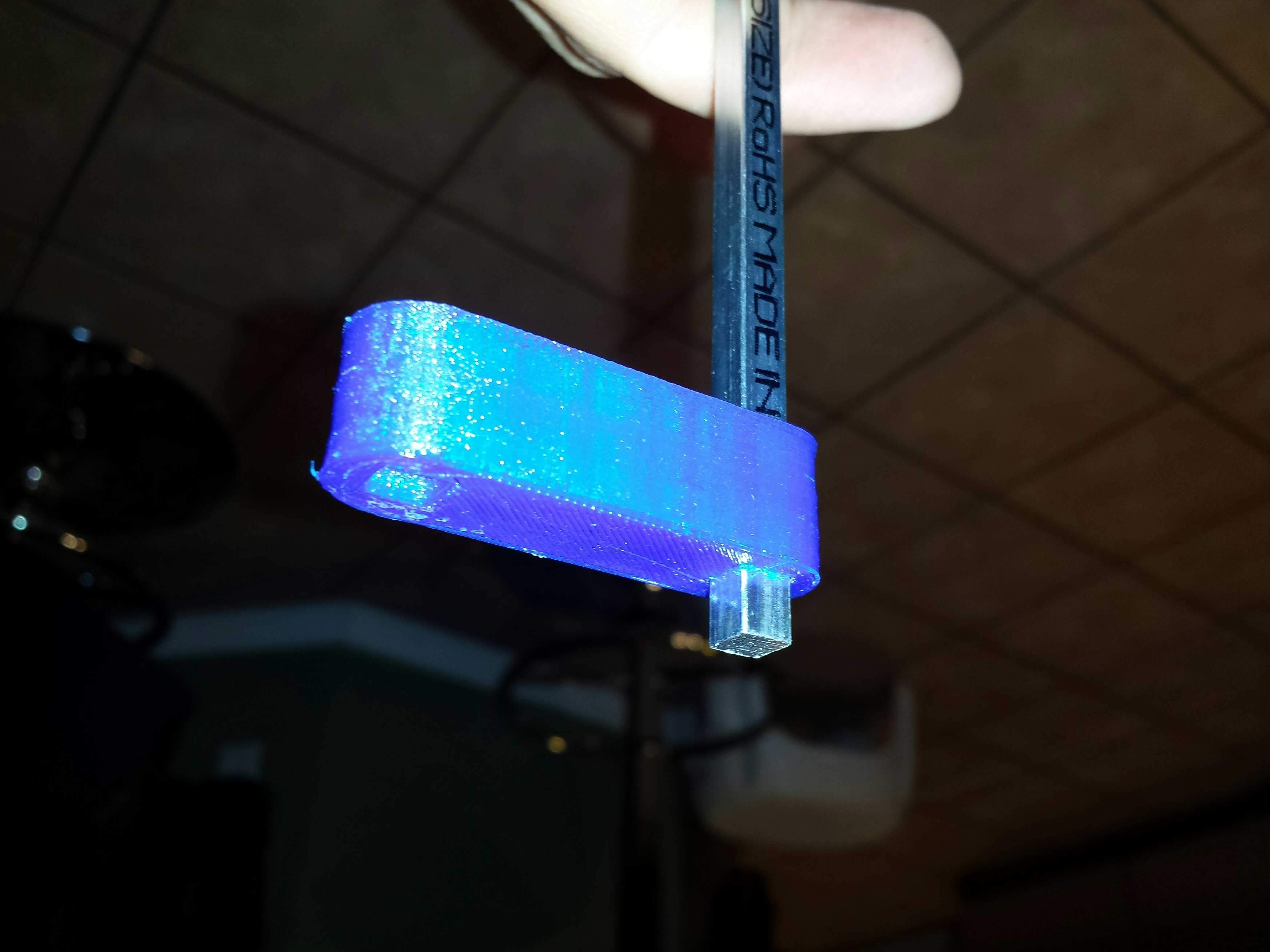

The printer gods are smiling on me tonight! This is a cam for a Halloween prop. I drew it up in sketch up with 1/4" square holes, told kisslicer to do one perimeter instead of three, and to inset surface 0.15mm…it’s a solid friction fit!
