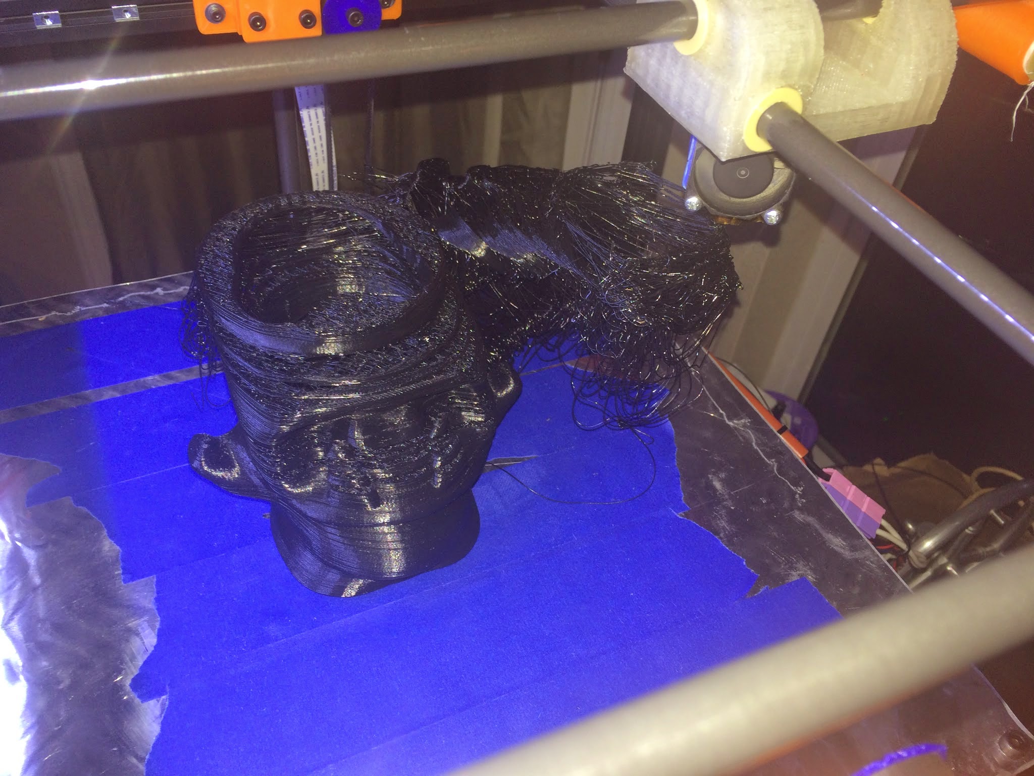

I guess this weekend will be spent with a large print trying to figure out why I have y-axis slipping, 4 hours into a print.
On an up note, it wa freakin’ SCREAMING (possibly the cause of the failure)…230% of 60 mm/s (so, you know, 140 mm/s) and the surface quality was GREAT.
At least now I have a test candidate for ascetone testing.
Looks like a nozzle catch caused missed steps shifting the print?
Yeah most likely, might need to up the reference voltage a little as well. Nothing’s getting hot, so there’s space for a little more holding power.

@Mike_Miller Try adding some Z lift. I occasionally had axis shifts due to nozzle drag. Z lift seems to work very good on the belt driven Z.
I will, there’s .3 mm now, but I’ll go higher.
