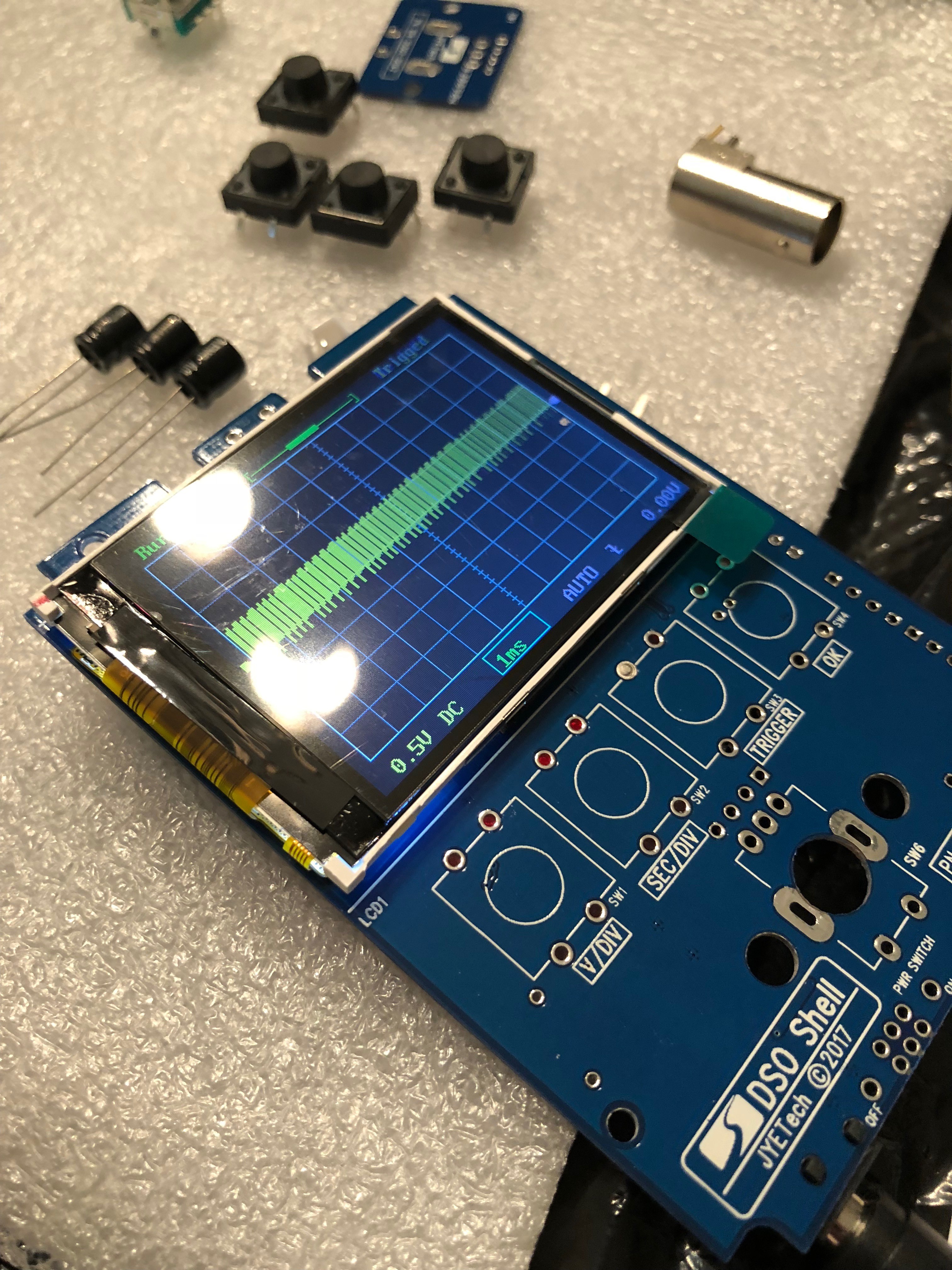

The scope appears to have arrived in good shape. Tonight I have to solder all the pieces together.
Watch a Youtube video of someone putting it together before you do. Because some bits of it are weird. Like the one knob is upside down compared to how one might think it is supposed to go. The ground stake is a bit of a bone of contention as far as which side of the board it sits better on too. Also you need a pretty strong iron to get the BNC jack soldered to the board. I remember that giving me some trouble. I also used masking tape to hold the screen to the board while I was working on it. It kept the screen from flapping around. That was a trick I picked up off a video. It worked good. I might not have thought about that on my own in the moment either. But it is an idea I wish I could say was mine.
Probably the worst part of the build is not soldering the board but putting the plastic shell together. Once you get it together it’s OK. But it’s like a Chinese puzzle box to assemble. As I can recall you have to slide the one panel on the stake first or it won’t go together? There was something weird about it. Like if you didn’t put it together one particular way forget about doing it. So save some patience for that step. Just don’t get too excited when you’re done with the board because you’re not quite done yet.

@Daid_Braam they’re all over the place. Aliexpress, Banggood, Amazon, ebay. So it depends where you like to shop. 15001K DSO shell should turn it up. It is the redesign of the DSO138 which had a few problems. I think I got mine off Banggood when they were having a crazy sale. I remember paying $14 or $16 for it? They regularly go for around $28 it looks like.
@George_Allen one more thing about building the scope the buttons can go in two ways but only one way is right. So be careful about that. Well I think they go in a bit better the right way. But it is not hard to put them in turned 90 degrees. Mistakes are what cost in building kits so just don’t make any.

@Paul_Frederick I very likely put the buttons in wrong. I didn’t see your whole post. I’ve been working on so many different things. I know for a fact that I made some errors…I put the encoder in before realizing it needed to be soldered to the supplied board. While trying to remove it, it melted. I ordered a replacement from a distributor in the UK. Also, it wasn’t clear which side to solder the power switch to and I later discovered I soldered it to the wrong side. The kit didn’t come with resistor #4. I’m not sure if that is no longer needed or if they just forgot to include it. Also, reading the writing on the parts and board were not designed for someone with my eyesight. I know I will need it though to troubleshoot my wiring. One of the motors on the table was working improperly…I feel it’s a wiring issue related to my wiring of the aviation connectors. I’m headed downtown after lunch to check it out. I think I’m going to resolder all of those connections. I can’t get the spindle wired until next week anyway.
