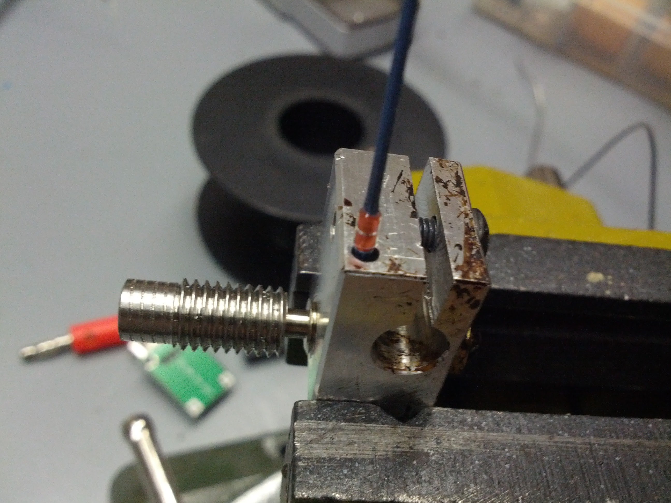

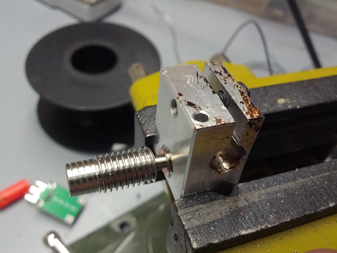

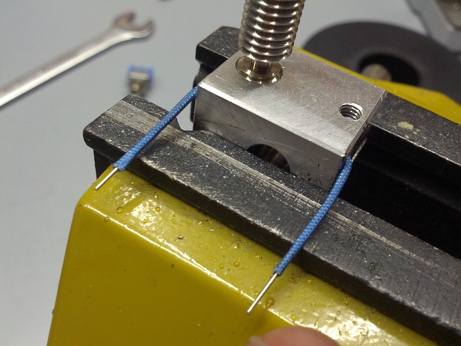

I do have a spare Semitec at hand, but i wanted to try an axial thermistor instead since i was really happy with the one my Budaschnozzle used to have. So far, the axial one works well after adding an extra hole to the heater block and some fiddling with the PID values, which makes me wonder - why are E3D not using axial thermistors as the default option?

First of all, i personally wouldn’t mind a DO34 or DO35 thermistor being tied to the heater block, since they are pretty robust little things even when you secure them just by bending the legs over. However, it could be user-replaceable if the heater block was a two-part design, with the second part being a clamp/trap for both the heater cartridge and the thermistor. Alternatively, using removable, spring-tensioned connectors (similar mechanism to WAGO Klemmen 273-100 3x1 5 Qmm 3polig 100 Stk online kaufen | eBay , i’m sure they’re available as miniature versions somewhere) would allow the thermistor to be used without any permanent connector attached.
