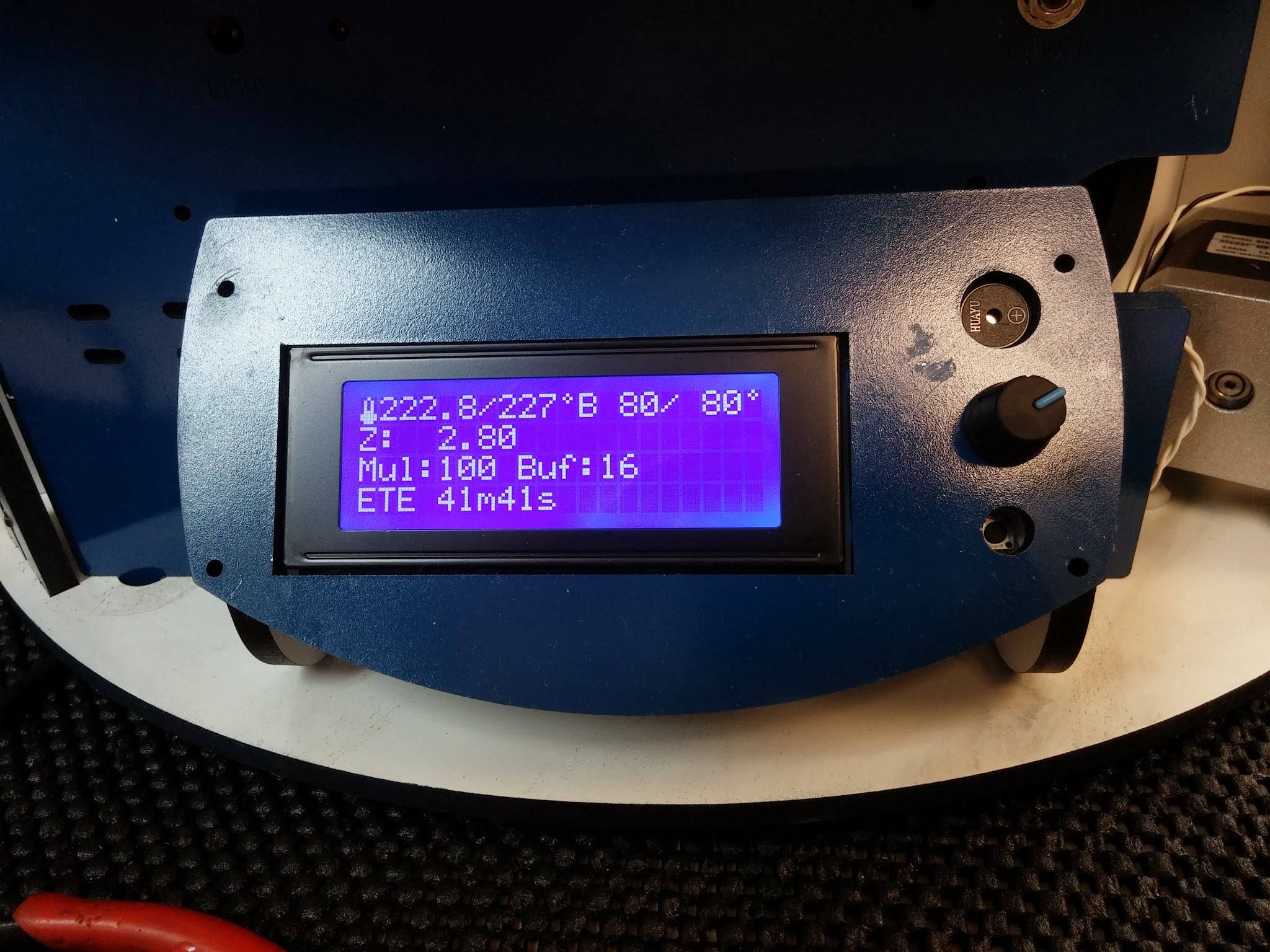

The first couple prints of a calibration cube I stopped mid print to re-apply ABS juice or adjust bed temps, run another PID auto-tune, and make a very slight adjustment to my z-offset. I’ve included a gallery of some of these parts and a video of its current operation. I’m running around 60 mm/s, which is fast enough for me, with ABS and no fan on the hotend.

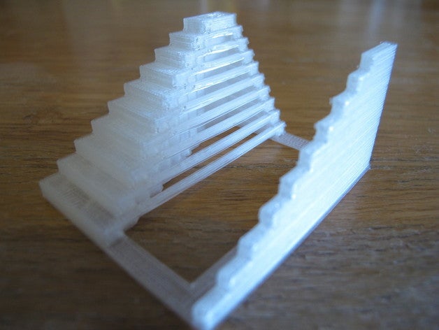

@Anthony_White Well, there are a few things I would recommend printing, but they are not all calibration objects. Here is a list of links.
Thin walls and bridging.
